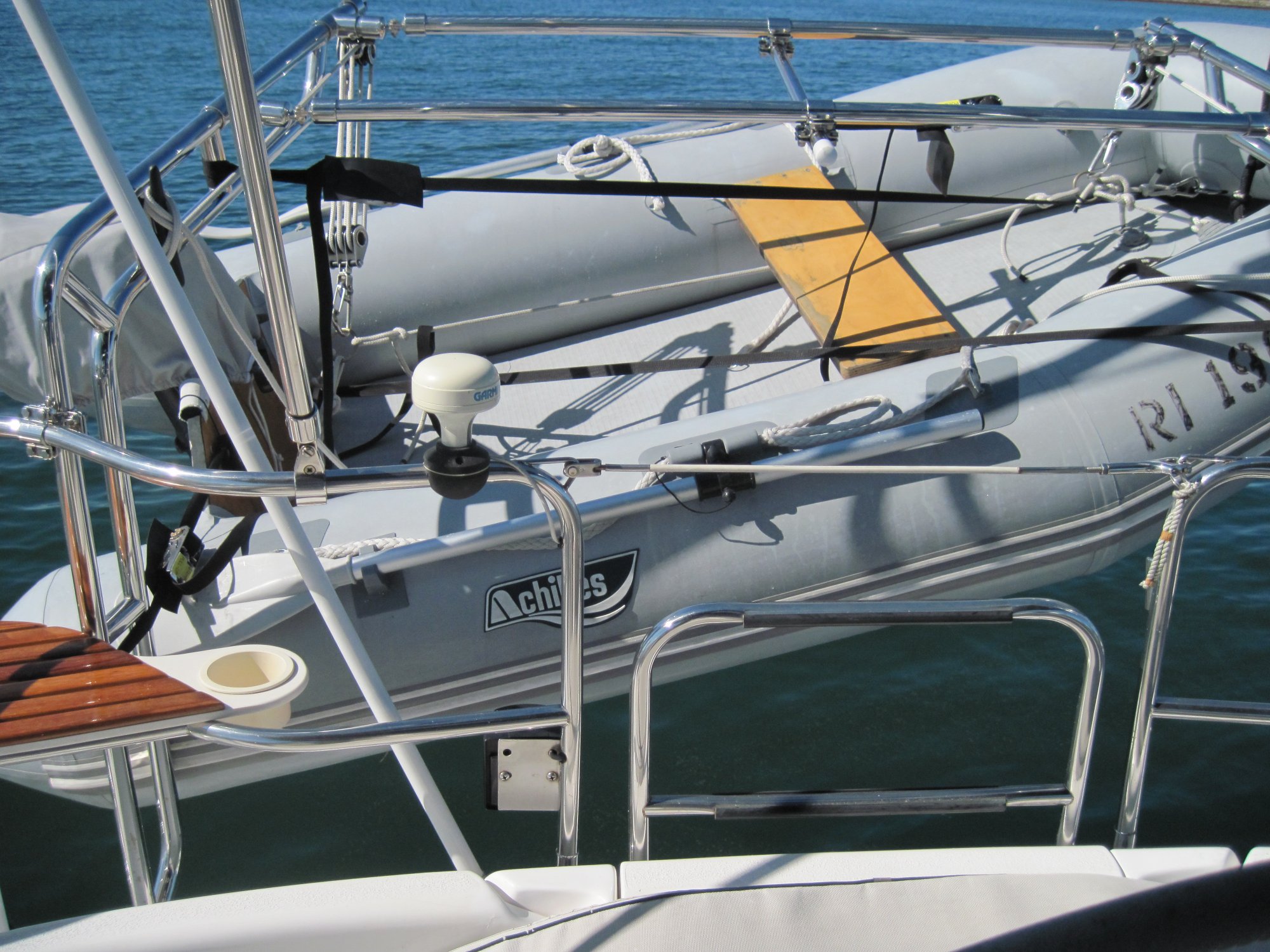

I have bars parallel to each Davits like left to right and I have ratchet straps go around dinghy and
the strut barts so that the dinghy is strapped to those bars and have felt protection wrapped around
the vertical part of protection to keep from chafing.
Works great.

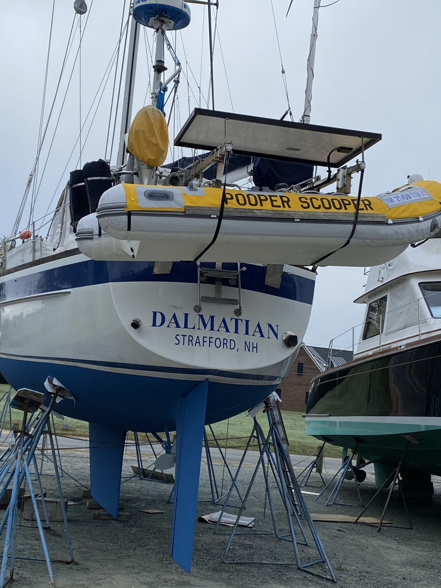

We have ratchet straps that hold the dinghy against pads on the davits.
