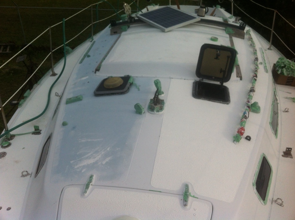

We are in the middle of repainting our entire boat. Decided not to go with the expense of a 2 part paint and am using Rustoleum Marine paint and primer I got on Amazon. We like the results. For the nonskid we decided to not skimp and are using Kiwi Grip, love the stuff.
Prep is were it is at. Sand, prime , sand etc. very time consuming and makes me think the cost of the paint is not as much a factor as the time spent to do it right. After working 4 or 5 weekends just to get the topside done a few extra bucks on per quart probably would not have killed me.

I used the Rustolium Primer listed with the paint on Amazon. Cost twice as much as the paint but covers very well. We primed the top side with about 1/2 a quart. Have 2 quarts more to prime the freeboard now that we are finaly done with repair and prep on that part of the boat.
Here is a picture of what the new paint looks like. Not the best light. I will try to get a better picture this weekend as the Kiwi Grip is now done. The Rustolium is White Semi-Gloss. White Kiwi Grip.
One note on the Kiwi Grip is it took 1 gallon and 1 quart to do out topside and we did not do inside the cockpit or the top of the sliding hatch. We had to put it on pretty thick as we went from blue to white. On the white Seahood (not yet done in the picture) we were able to put on only half as much using our plastic trowel and love the results.
