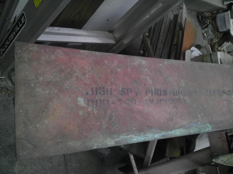

What length do you need? I have a couple of hundred pounds of copper sheet stock. Pm me your address and I'll send you some.

hey all, I got some metal from CAGUY, but that wasnt copper.. it was brass... and it was big, and I mean huge.. hehehe
It was also half the thickness of the stock material... I tried to get it bent but it was too brittle and it kept breaking...
I ended up using it even though it was thinner... and the width was a little bit of an issue too as I couldnt trim it under 3/4" with a metal brake...

What I sent him was Phos Bronze. It is used in marine environments over copper because of its resistance to oxidation. It has a higher copper content than does brass which makes it suitable for electrical connectors.
