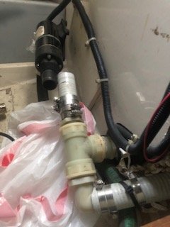

catalina 309 New Bern, NC
A dumb question i know, but i cannot find the mercerator pump in my recent purchased 2006 Catalina 309 where is it?? (when turned on at the panel, I hear nothing, but I think i did originally)
16,082
CAL 35 Cruiser moored EVERETT WA
Not a dumb question, but you do need to look for it in the right place.
Do you know where you Black Water holding tank is?
You should have a hose emptying the tank. Follow that to a Y connection with a valve. One path goes to the deck connection which allows you to suck out the contents of the holding tank. The other side goes to the through hull to dump your holding tank in the open ocean. Along this second path will be your macerator pump.
If you stay inside the 3 mile coastal limit the CG requires your through hull valve to be locked so the holding tank deck pump out position is the only way to evacuate the waste effluent. Some previous owners may even have doubled down and disconnected the pump from the electrical panel which means you would have no pump sound when you flip the switch.
