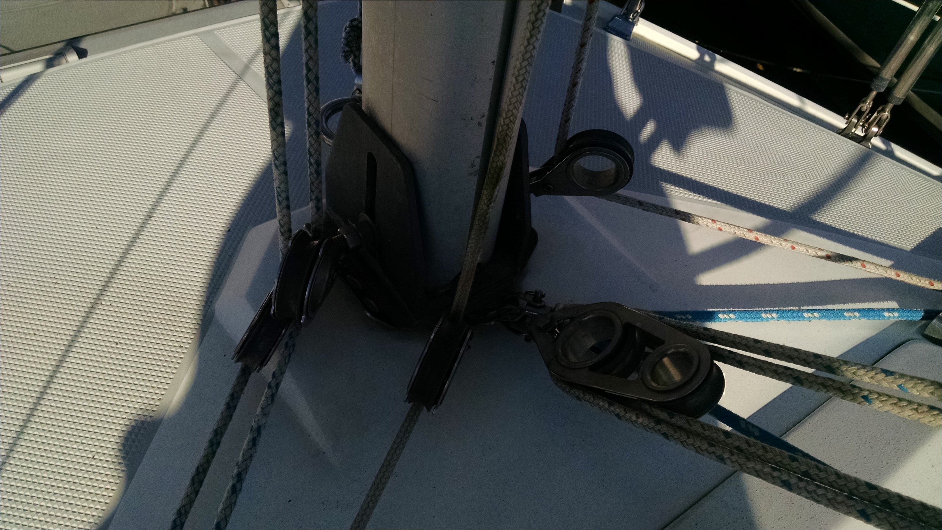

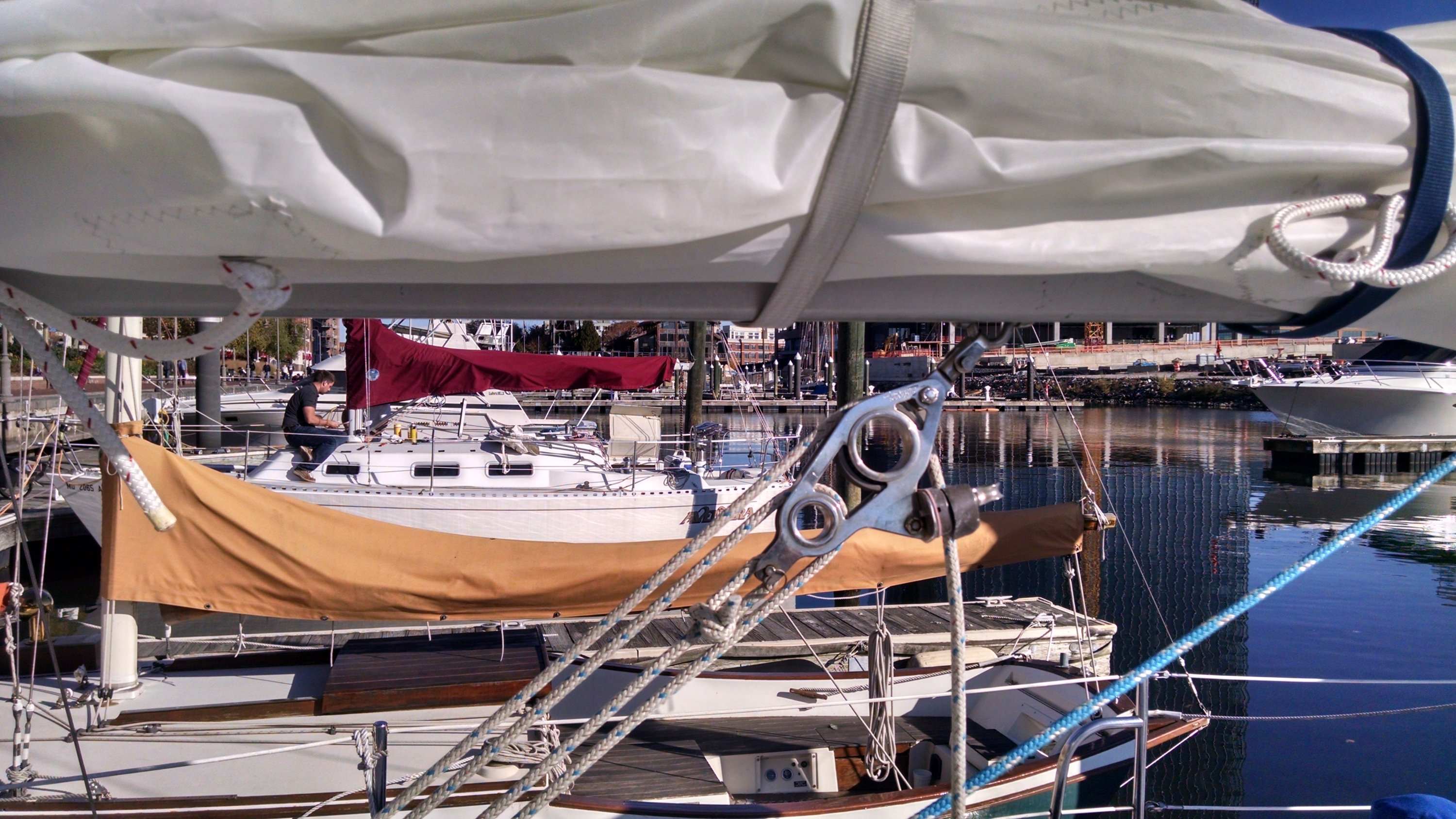

Scott. Here ya go. One pic is of the top and the second pic is of the bottom which is attached at the base of the mast. I snapped the pics last fall before I put her up for the winter.
Also you should join the Yahoo 270 group. Some interesting stuff goes on over there.

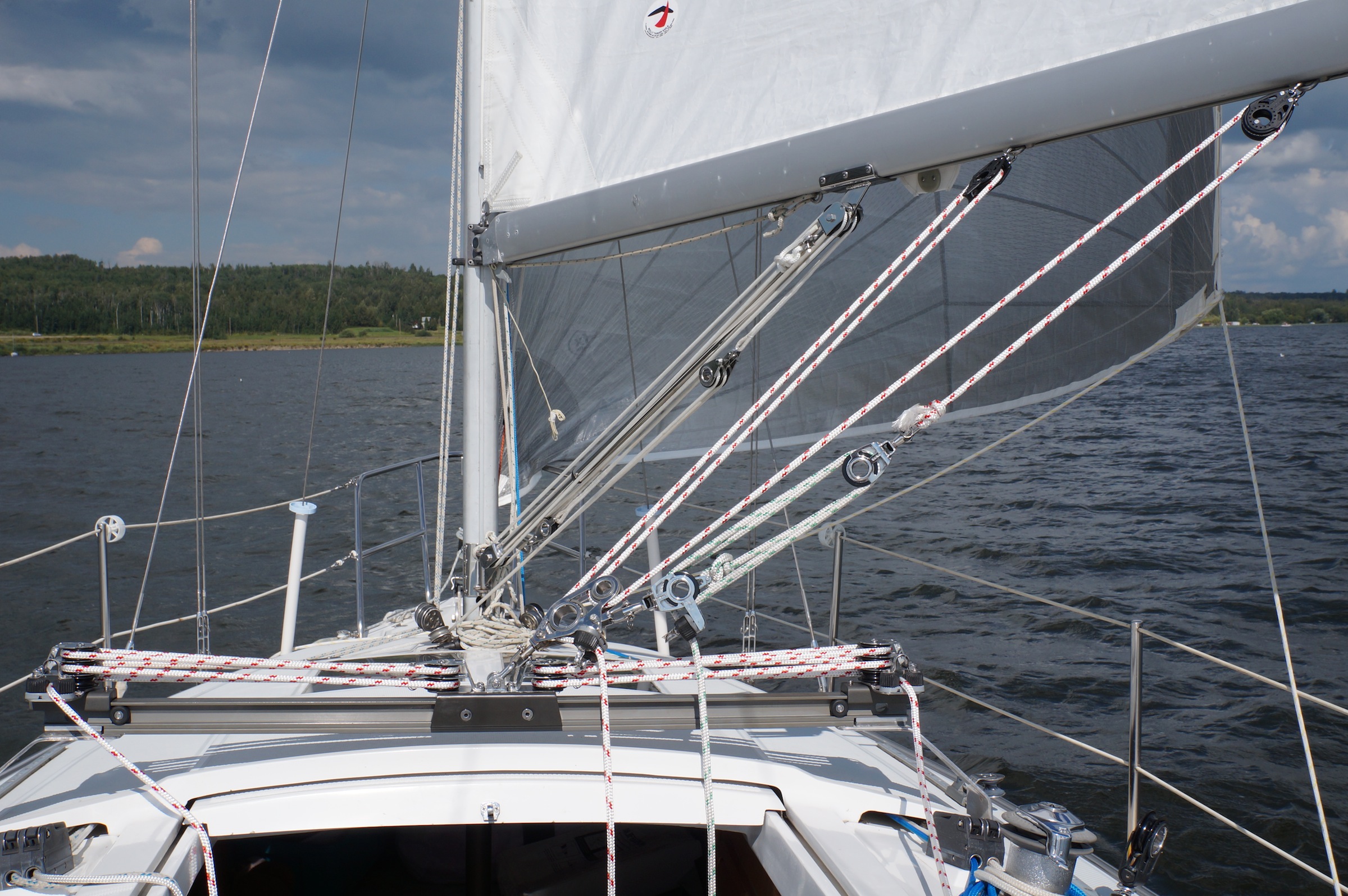

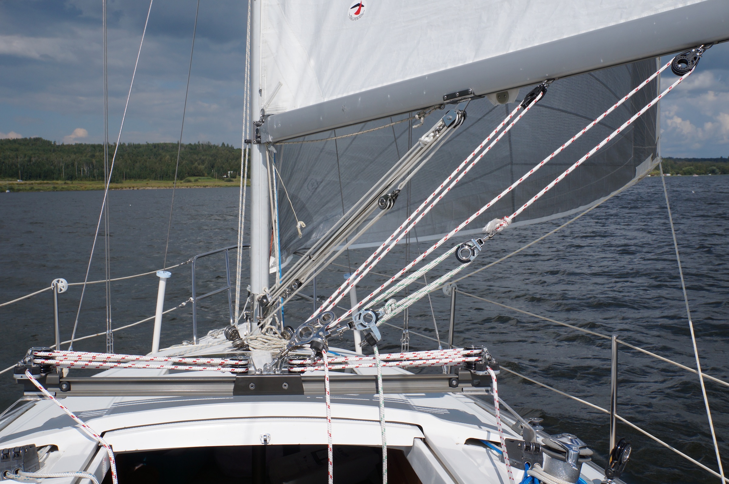

Added a Garhauer gas vang two years ago, and it's fantastic, even in no air, it'll let the main have a little bit of shape that it wouldn't have otherwise. Downside is that it's attached to the boom and the line better be tied off before taking it off the mast.
So far, so good.
Looks almost identical to John's 30 picture.
Aug 1, 2011
3,972
Good eyes! I thought I had (in fact I know I have) newer pictures, but as usual the organizational department here is out to lunch. August 7 2013 according to the meta data.
Since the boat is finally in the water, the mast is tuned and all that's left is to put the boom on, I'll get a better shot on the weekend, before we haul it out for winter. :)
