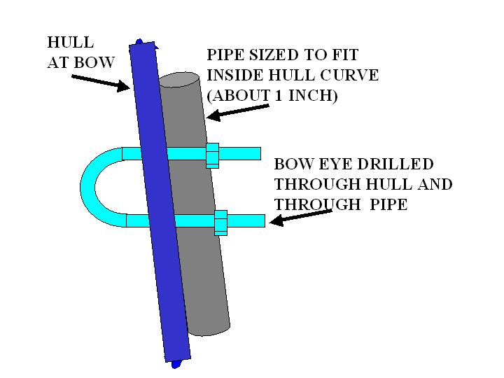

Jonathan, you are right about the steel cable not stretching like the nylon strap. I have attached a drawing of putting a pipe inside the bow to reinforce the bow eye. I now have this on my h23 and my h27. Both of which work like a champ in strengthening this area. Test different diameter pipes to find one that best matches the inside contour of your bow. Ward

I've stomped, and welded my trailer to repair stress cracks. Liquid soap has been used to dissipate oil slicks from fuel spills, and environmentalists claim it is worse than the oil. I pull mine out, winch, and after a few miles winch again for the road vibration and normal breaking ease the boat forward under the cable tension. I agree with Rick in estimating the strenght of that eye, and Ward's design would remove all doubt. Mark Major s/v Lesismor 86H23

I have a 240 and the bow eye pulled loose after five years. Looked here for suggestions and found one that was a good suggestion of using galvanized pipe to put the bow eye thru inside the bow. worked great but the size was off. needed to be 3/4" x 15". You should not have a problem. I have been towing my boat which is heavier than yours. I usually try to get it on the trailer as far as possible then winch it the last few inches. Hunter sent me a new ss bow eye at no charge when I stripped the threads on the one I had. It had been cross threaded at the factory.
