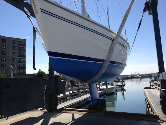

We redid our bottom last year. We had the marina pressure wash down as much as they could (paid them extra for it). Then it was hand sanding. I don't like the idea of media blasting on gelcoat.
We put two coats of Interlux 2000e barrier coat, mainly as a primer for the paint since Catalinas of our vintage don't need barrier coat for blisters. Then 2 coats of Pacifica Plus. Very happy with both.
