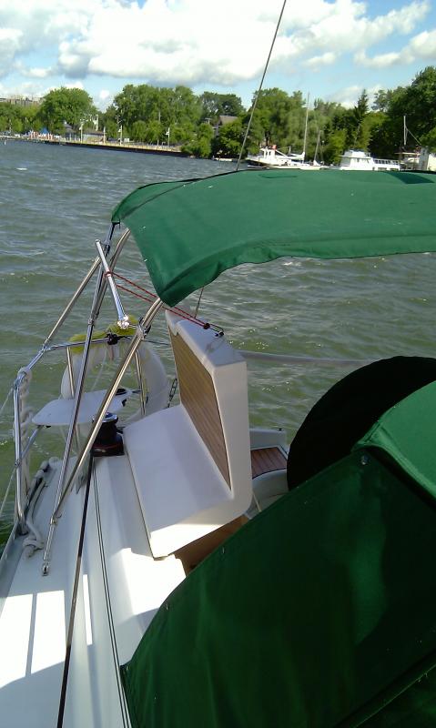

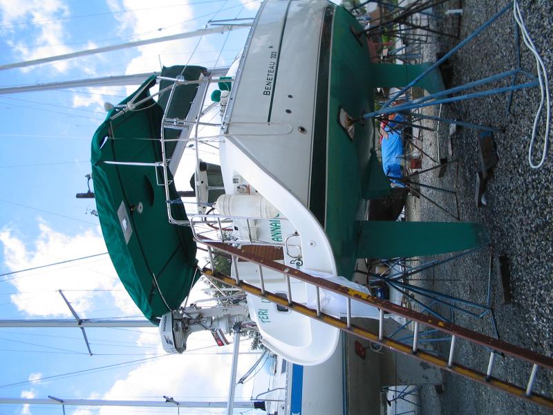

How do I keep the bimini from folding backward in high winds? Its a standard cover and frame for a Beneteau 323. Thanks
On my 2006 B323 I placed two struts from the aft bow down to the stern rail, then struts between the front and aft bows. No support to the front bow needed. And it has held through 50 mph blows- maybe more?
Back when I had my Mac26. The Bimini was pretty simple. I had a flattening reef on the main this would raise the boom so it would clear the Bimini. When I wanted the Bimini out of the way all I had to do was ease out the boom and release the two front straps and Bimini would flip back just like a simple Miata convertible. KISS...... On the 356 I just last year got rid of all the straps. Basically the same as what you have done on your B323. The Bimini can now been unzipped and removed without screwing with any frame adjustments. Now that's the right way it should have been done the first time Bimini was installed. I guess the Canvas/Frame Guy had some job security issues.

Thanks for the feedback, I located the straps and have liked the functionality - allowing the Bimini to be tied back when not in use w canvas left on -
