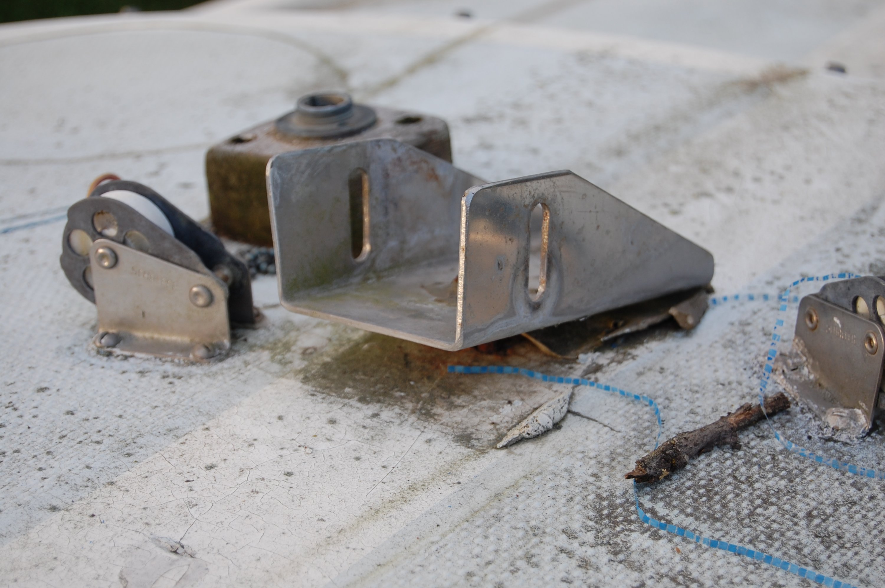

MAST
While recuperating I tried to take the mast down and dropped it. I lost a spreader on the port side (it snapped off pretty cleanly). The bottom is damaged but I think I have a solution to repair it myself. The mast step plate needs replaced and I will obviously have to inspect the underside for serviceability.
Compression Post:
Looks like a crack and depression on the trunk where the compression post rests. Needs to be inspected and repaired.

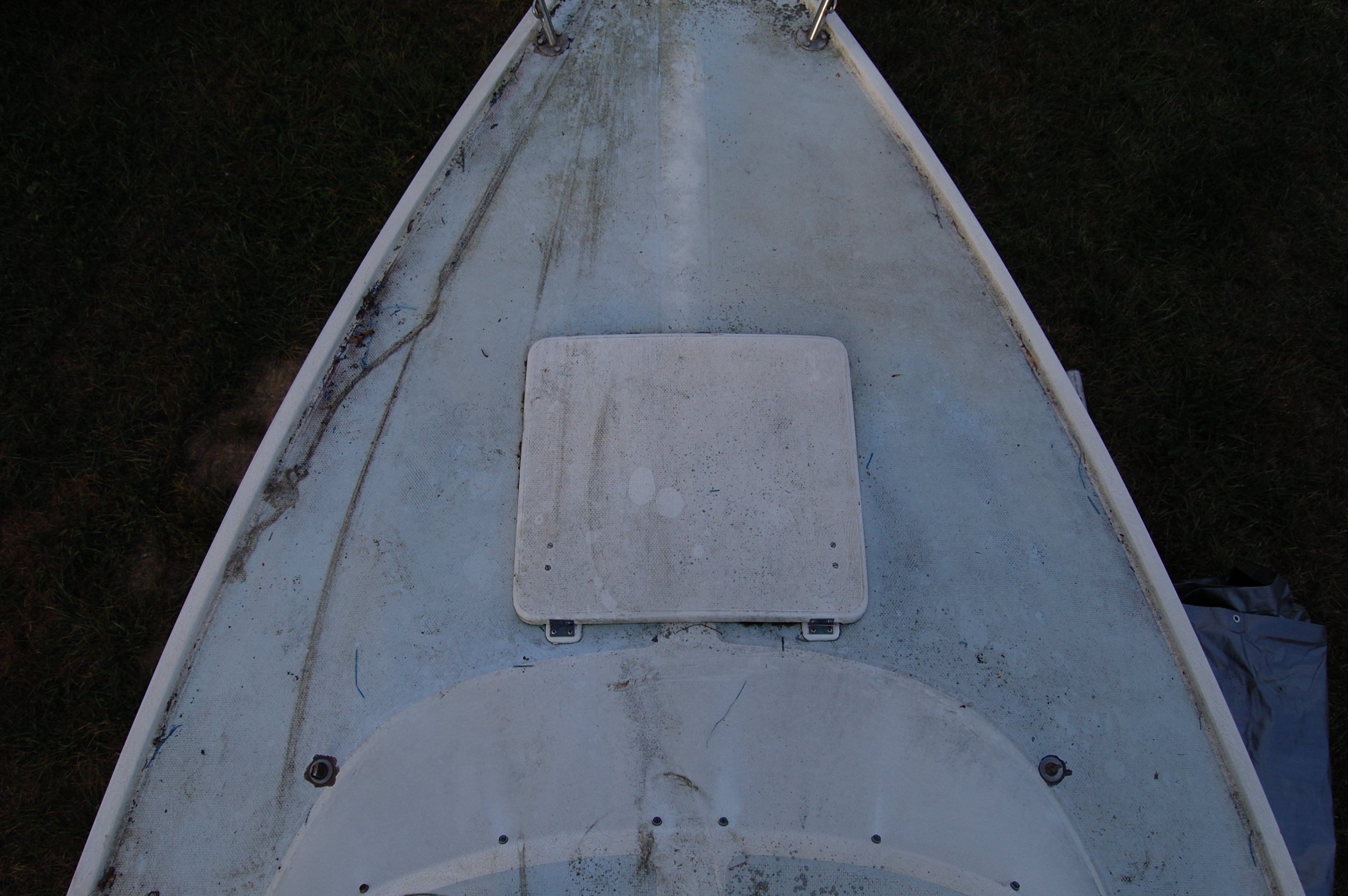

Topsides Forward Deck:
In the picture below, to the right of the forward hatch, the deck gives just a little but seems pretty solid. On the left however, it has a lot of give and is mushy. From the bow to hatch is somewhat flexible. Opinions welcomed on this as I just don't know what to do. Obviously, when everything else is fixed, this won't prevent me from sailing.

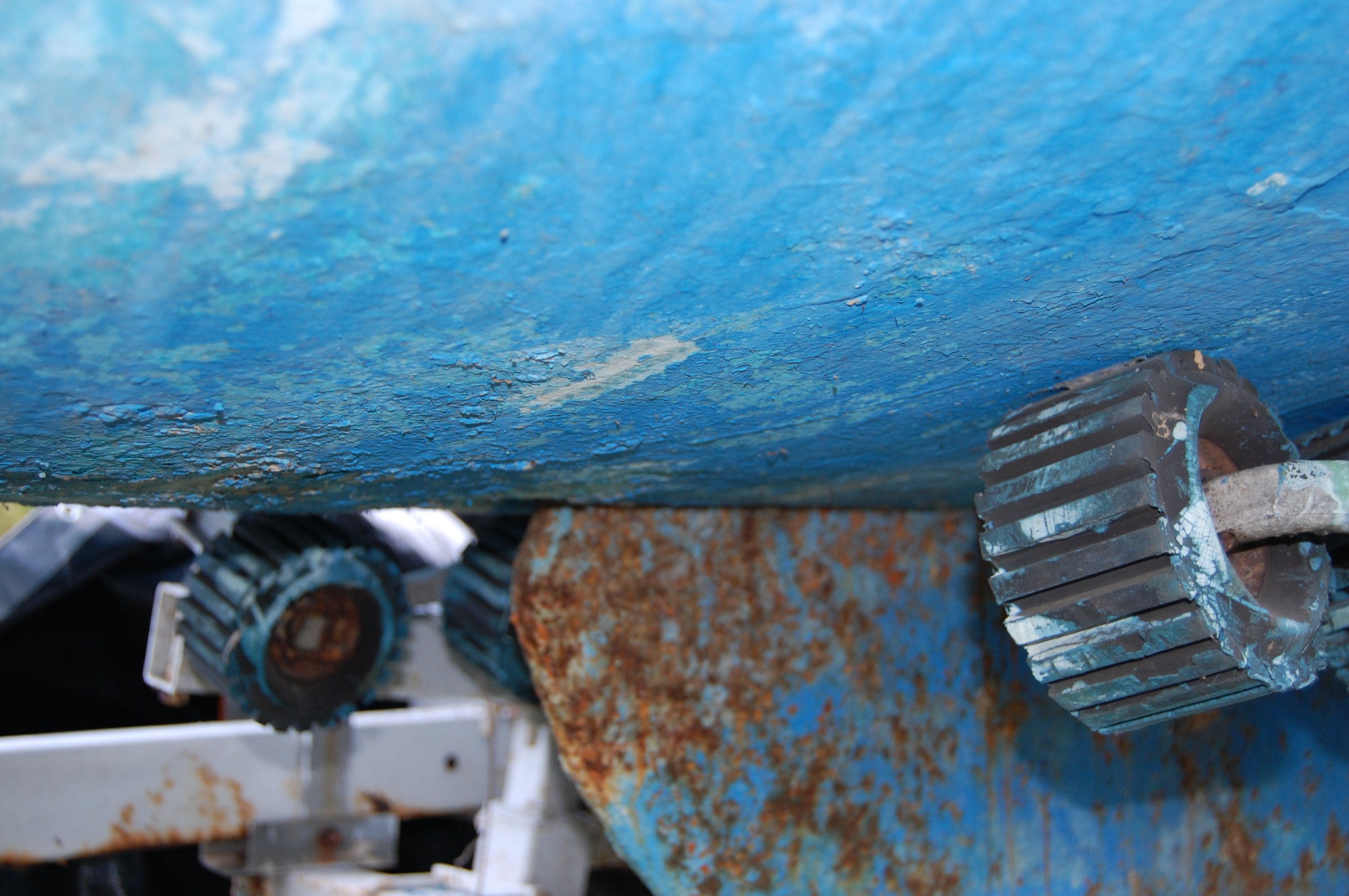

Keel:
Need I say more? It's a Catalina 22 for crying out loud. It made the obvious clunking noises when I first sailed it but didn't know anything about the keel issues then. The yardman at the marina did say, "I'm surprised that keel isn't at the bottom of the bay somewhere."

That crack at the compression post is usually due to a rotted wood support which is under that fibreglass, which transfers the load to the bottom of the hull. Some people have cut a hole in the top and repaired it, others have done the repair from under the dining table seat. Usually requires removal of the compression post
For large deck areas, with rotted wood coring, you would normally have to cut out the top of the deck, remove+replace all the rotted wood coring, epoxy the deck skin back on, and paint the deck to hide the repair.
It's a hell of a LOT of work just to get the hull solid, with the compression post support and the rotted deck coring.

If you are a do-it-yourselfer, it really doesn't look bad to me. I am not sure what is wrong with the keel. Just looks rusty to me. You should have seen mine when I bought it ;) . I would fix the mast, step and post and go sailing.

Even if I actually liked working on boats, I'd find a better boat. Ugh. See what you can get for the scrap value of the keel, and the trailer, and junk the rest.

You know, I've seen a lot worse. The crack in the mast step is a concern, but you could probably sail her for years without the mast going through the hull (or whatever other disaster the other posters think will happen...). Even more with the deck: a spongy deck says the inner sandwich material is rotten, but that doesn't mean the deck will collapse imminently. The mast does look like it needs some work, but I can't see exactly what's wrong from the picture. And I can't see what the problem is with the keel. You WOULD need to ensure it doesn't fall off... ;)

Spongy fwd deck- if you are not planning on spending time jumping on it, find find the leak, seal it and go sailing. If you want to repair, go from under - remove or cut out liner area, glue up new core.

The wet wooden block under the mast in the cabin is serious....we were racing in a Catalina 30 in some pretty stiff winds and the cabin top split from side deck to side deck right thru the mast step...the side stay broke but we were not dismasted....we limped back to shore and the owner began looking for a cause and discovered enough water in the bilge that the wood blocking for the mast had decayed to the point that he could stick a pencil thru the block of wet wood......He did repair the supporting block (or put in a new one); I'm not sure which....but it has not happened again....but wet wood blocking under masts can be a big time problem...
