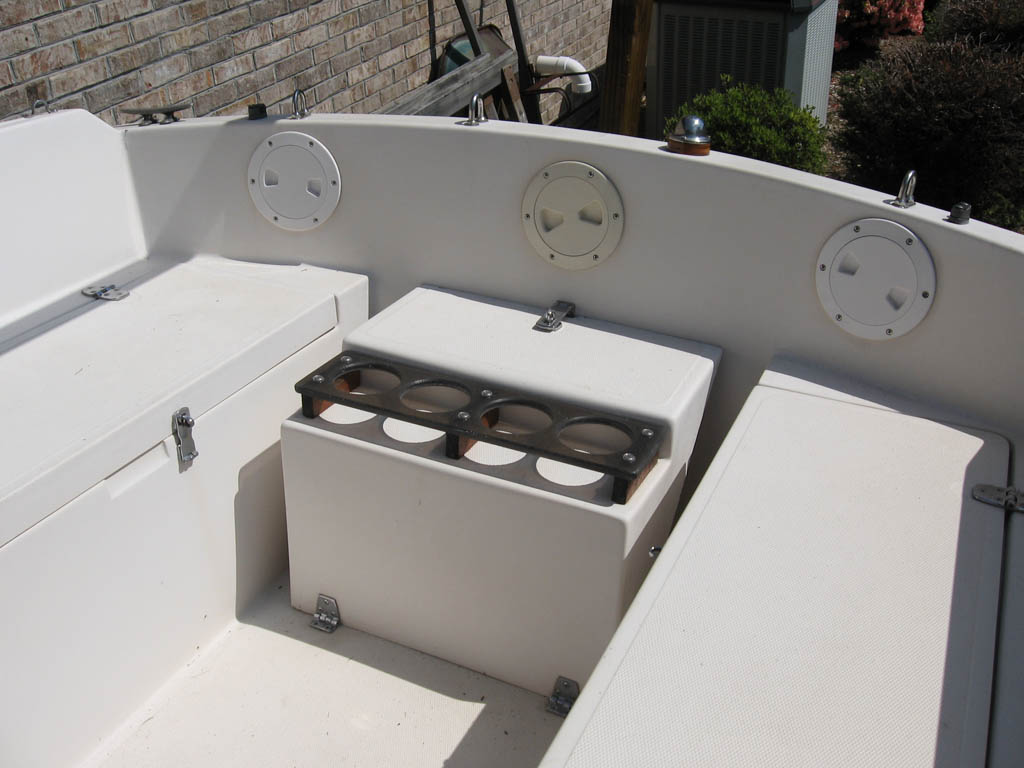

I needed some u-bolts on my transom to accommodate a split-backstay modification. There was no way to get into the backing space, so I made a way. Not entirely elegant and might be more trouble than it's worth for what you're doing, but it's another option to throw on the pile.
