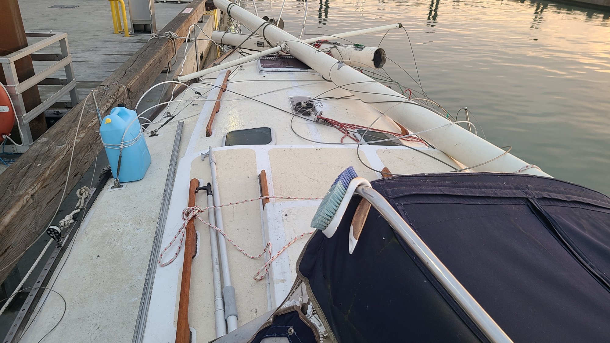

I'm looking for a solution to fix or replace the broken mast on my Buchan 37.
20220924_070446.jpg20220924_070932.jpg20220924_071019.jpg20220924_071033.jpg20220927_172314.jpg20220927_172327.jpg20220927_172332.jpg20220927_172338.jpg20220927_172415.jpg
The geographical location is New Westminster, BC Canada.
I checked with Lynden, WA, and a couple of mast makers in Rhode Island and California. So far I got two crazy price tags for only new masts from the US, but the cost is minimum triple the price that I paid for the whole boat. I refuse to believe that no one in BC can help with this. I mostly feel that my old mast is a scrap and not repairable anymore but it would be nice to listen to opinions from gurus.
My heart bleeds at a total loss of the boat like insurance is offering, especially after very hard work that was done for the last two-plus years of an extensive refit. So many things were fixed, replaced, and upgraded. And there were more plans for DIY fun.

It is a challenge finding replacement spars for boats. Problem is matching the needs of a boat built in the 60's with the strength requirement to handle blue water conditions. When you buy a used boat the mast and standing rigging has been discounted to nearly nothing in the price.
Looks to be a deck stepped mast of 45 ft. A lot like, the mast on my 35ft CAL. You could try to find a damaged boat with a good mast of approximately the same structure. I am afraid it might be like looking for a needle in a haystack. You would need a list of the specks:
Diameter, length, thickness of spar, circumference, number of spreaders and position on the mast, etc.
Don't worry about the hardware and fittings. You will likely need to modify a used mast to meet your broken mast specifications.

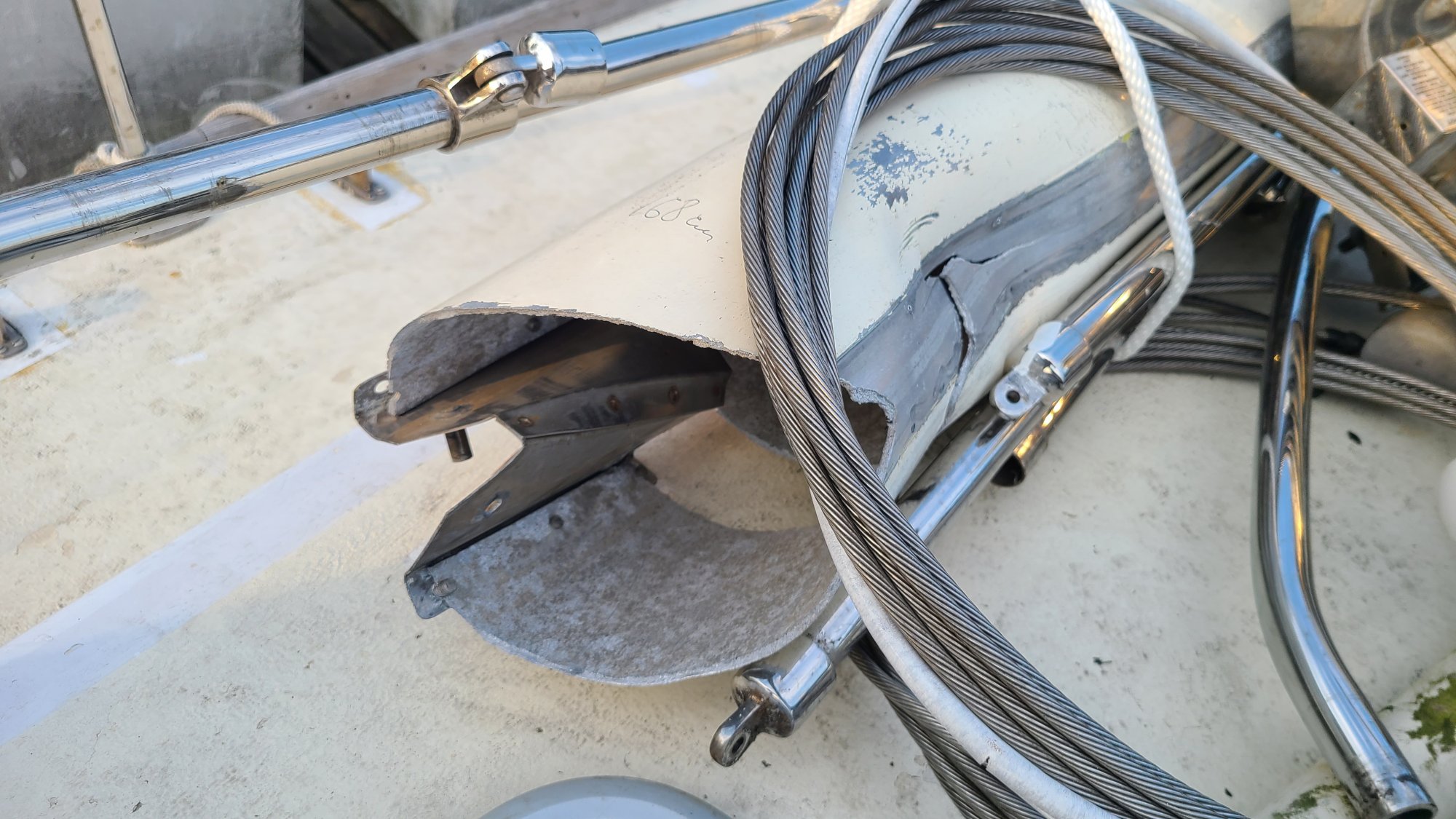

Hurricane belts are probably a good place to look for masts without viable boats attached anymore... but even then shipping it would cost a fair bit.
Looking at where it broke splicing might be an option especially if a similar section can be found or if you can 'live' with a slightly shorter rig.... We had a factory mast on one of our boats with an obvious riveted splice half way up.

It is not always possible to build and ship a 60 plus foot aluminum extrusion. Often masts are two or more pieces assembled together.

I'm going to recycle my old mast pieces. There are 3 chunks with different lengths. Should I just cut it to movable sizes and drive by the local recycle facility? Looks like no much can be salvaged but maybe reused as a compression post .
I removed all of the SS hardware. Most probably these will go to recycle as well.
