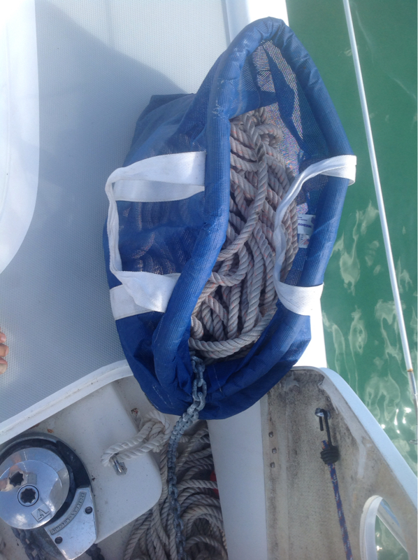

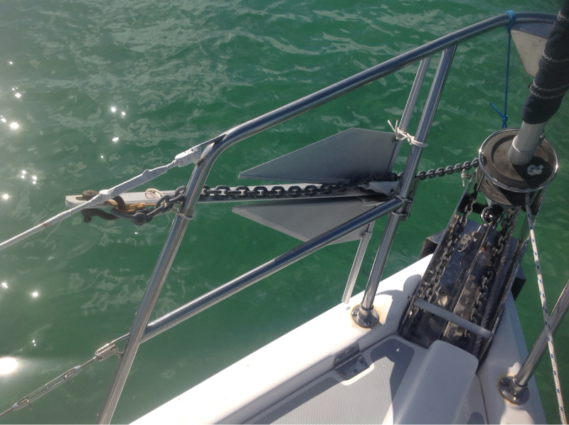

I have a Fortress mounted on the bow pulpit. I was worried a line could catch on it but so far no problem. I have the chain coming through the bow roller into a mesh anchor rode bag I keep in the anchor locker. I just lift out on the deck when anchoring with the Manson.
I think Fortress recommends very little chain on their anchors, maybe 25 ft if I recall.

hey Bob, thank you for your response, I was going to mount the Fortress on the bow rail but figured it would be a issue, worried about the head sail getting caught on an edge because the holder bracket would have to be mounted on the side of the pulpit because of the "cut away: of the forward section of the bow pulpit, isn't yours the same if so how and where are you hanging the Fortress?? your right very little chain needed for the Fortress.

Thanks Bob, got the pic's, that might work, i'll give it a try.

Here are a couple of pics of my setup. I'm sailing in Bahamas so Internet can be too slow for pics or not there at all !
Bob
