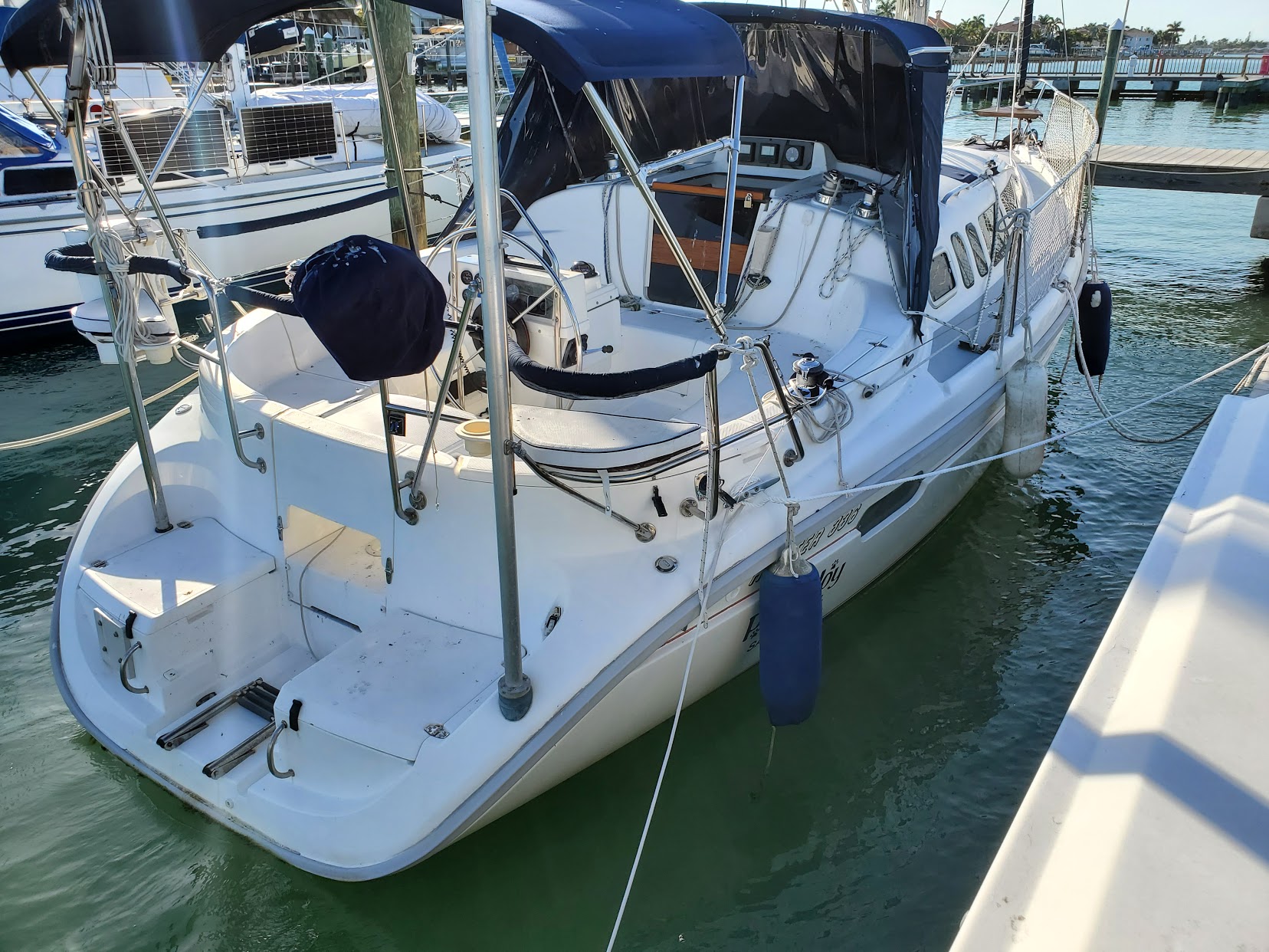

Greetings all. I have an offer accepted on this boat and waiting on survey next week. My gf & I love this boat except for the shallow anchor locker and the fact that she's not sitting on her lines. As a matter of fact, the transom hull to deck joint is nearly underwater where she sits. I've gone through the scoop lockers and there are 3 group 27's 2 to starboard 1 to port. Other than that I can't figure where enough weight would come from to make her squat so. I can't see under the pan, but I suspect that she's got a lot of water sloshing around. The pole to starboard is a 24 mile Garmin. The pole to port is stainless dinghy motor davit slightly overbuilt imho. The shallow anchor well isn't a problem because I have 200ft of 5/8" 8 plait windlass rode that will fit nicely. However, not knowing what's making her heavy in the transom is making me worry. Has anyone else encountered a similar problem?
Thanks in advance.
Mark
A few photos here.

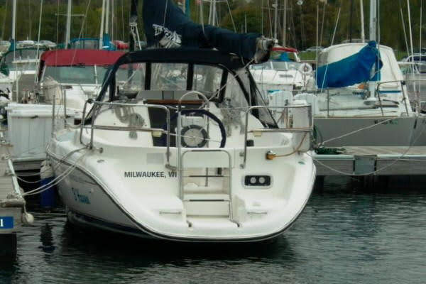

Pretty much in the ball park for that era :
Another oddity you will probably notice is the exhaust is a few inches underwater. Bought the boat as new in 1999 and no problems to date with approx. 2,200 operating hours.

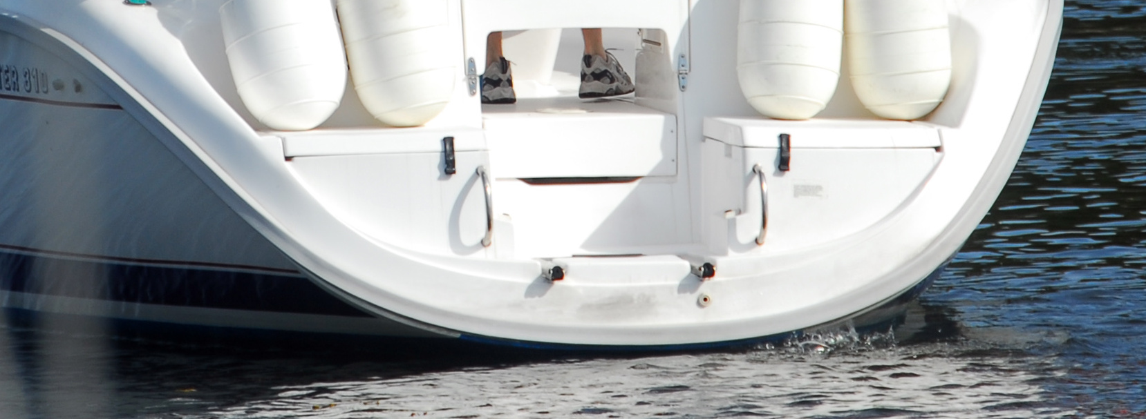

Some Hunters ride a bit higher, but even in high seas that aft area is water tight, all the way up to the steering pedestal.
Be sure and tighten your shore power covers too.;)

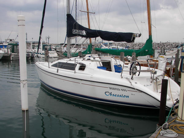

I had a Hunter 280...she sat down a little in the back...
unless we were over-canvasses and racing hard!
17580EF1-2C8B-48E2-80CE-BFB6AE7E9DBA.jpeg C774D2E0-0BFB-4411-BCC1-24046D652119.jpeg 611B8F8B-E64F-46C7-B24D-3D3D2ECECA7B.jpeg
and as someone mentioned, the exhaust exits under water a little... you cannot see your exhaust flow, but I was able to hear a different tone when I forgot to open the thru hull.
Greg
