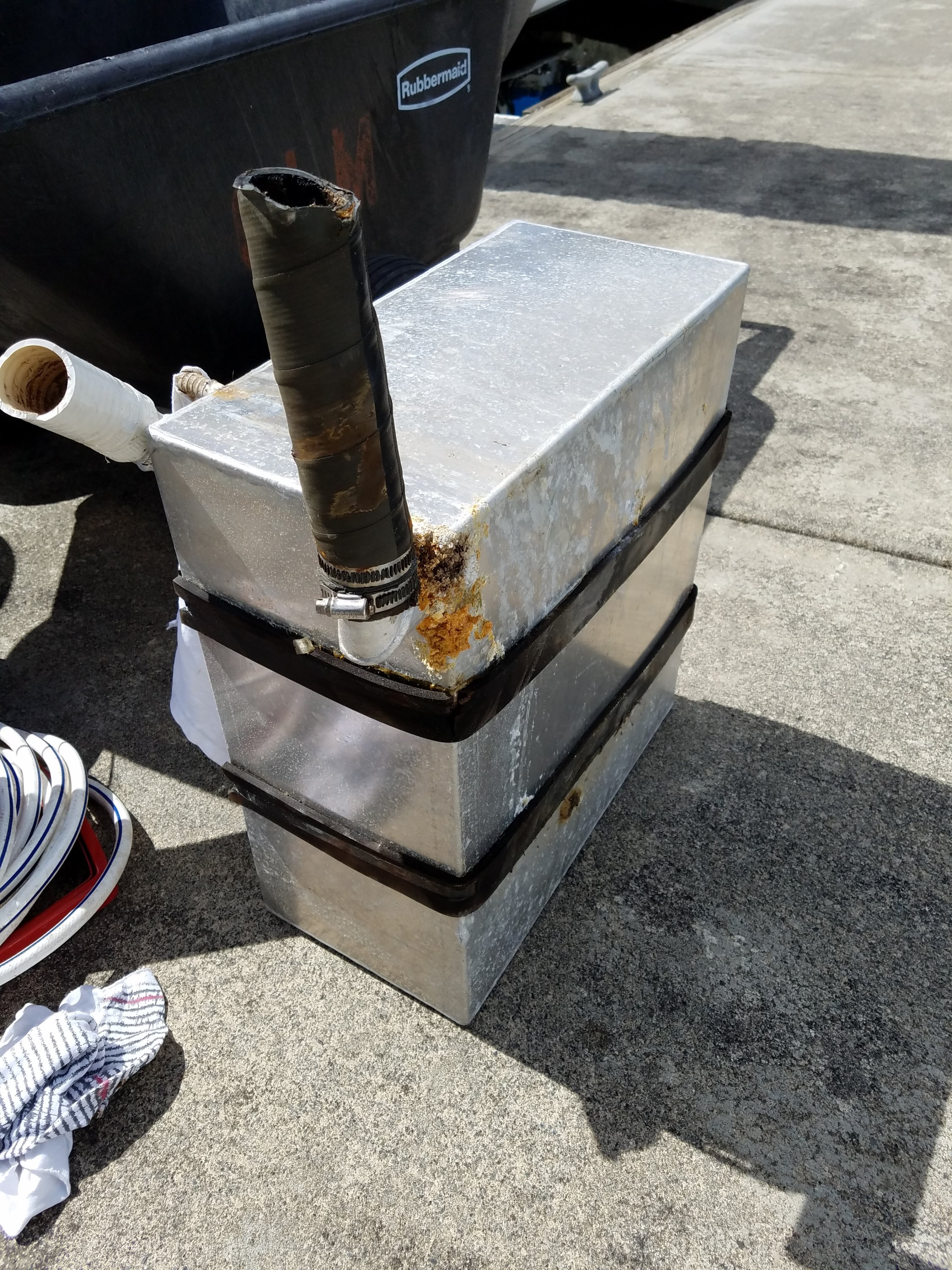

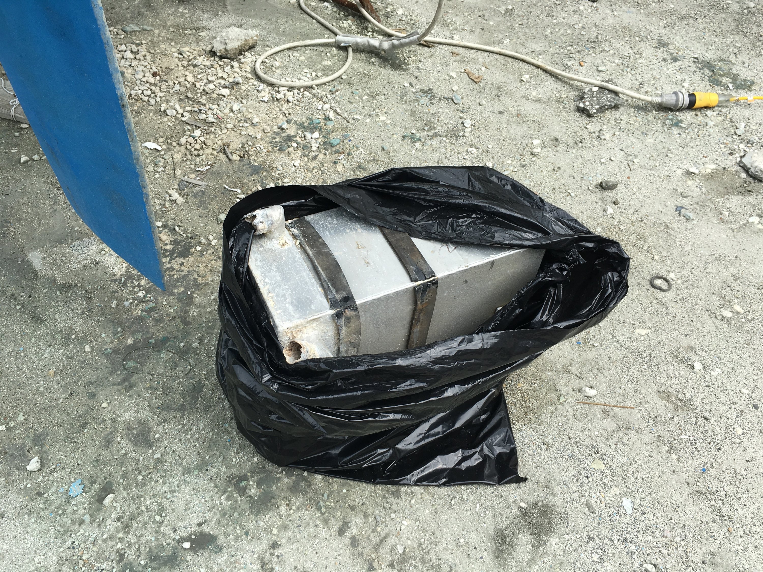

Here is what the holding tank looks like that came out of my 1990 35.5 Legend.
I just want to say that I read the book " Get Rid of Boat Odors " and took all the advice. I had very little clean up after I removed the entire sanitation system. My new holding tank showed up today. :)

Did you bring it out through the hatches in the swim platform? Are you cutting the bulkhead in the rear bulkhead to install a larger one
nfg2u
Feb 13, 2016
92
Hunter Legend 35.5 Fort Pierce
I cut the bulkhead, it had gotten wet and was delaminating anyway. Its only cheap plywood. I now have access to my engine batteries and the holding tank. I purchased a 25 gallon holding tank from Ronco. They were super nice and got it to me quickly. Couldn't have worked out better.

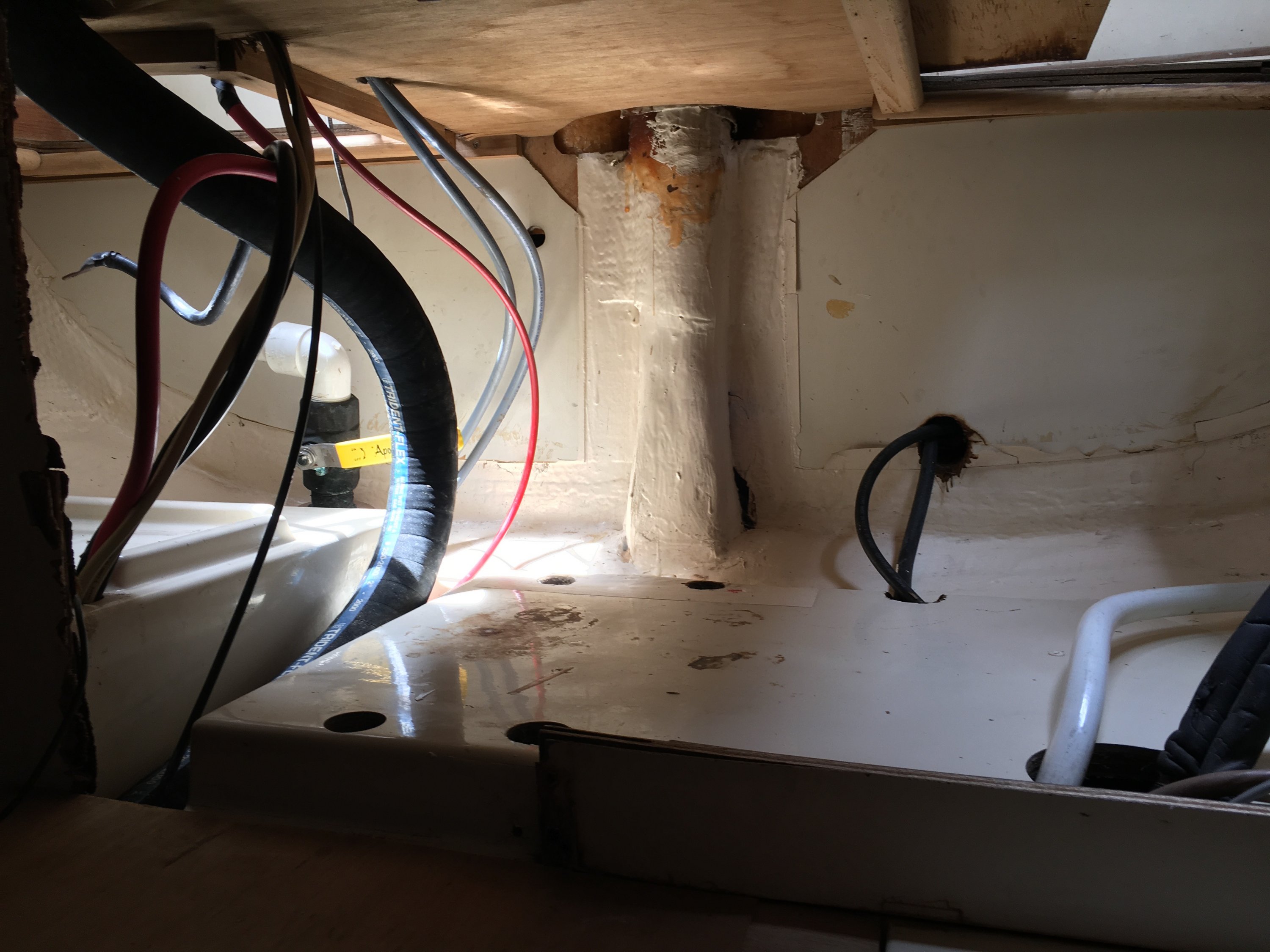

Hunter 1990 Hunter 35.5 Toronto
Mine looks the same but I was worried when looking at the bulkhead there appeared to be a hump in the center of the bulkhead when looking at it from the swim platform side and I thought there might be something fibre glassed into that bulkhead?
nfg2u
Feb 13, 2016
92
There is, the rudder shaft comes up through and the two boards are fiberglassed to it from the aft compartment. You can see the diesel lines coming through on the port side. Hope that helps.

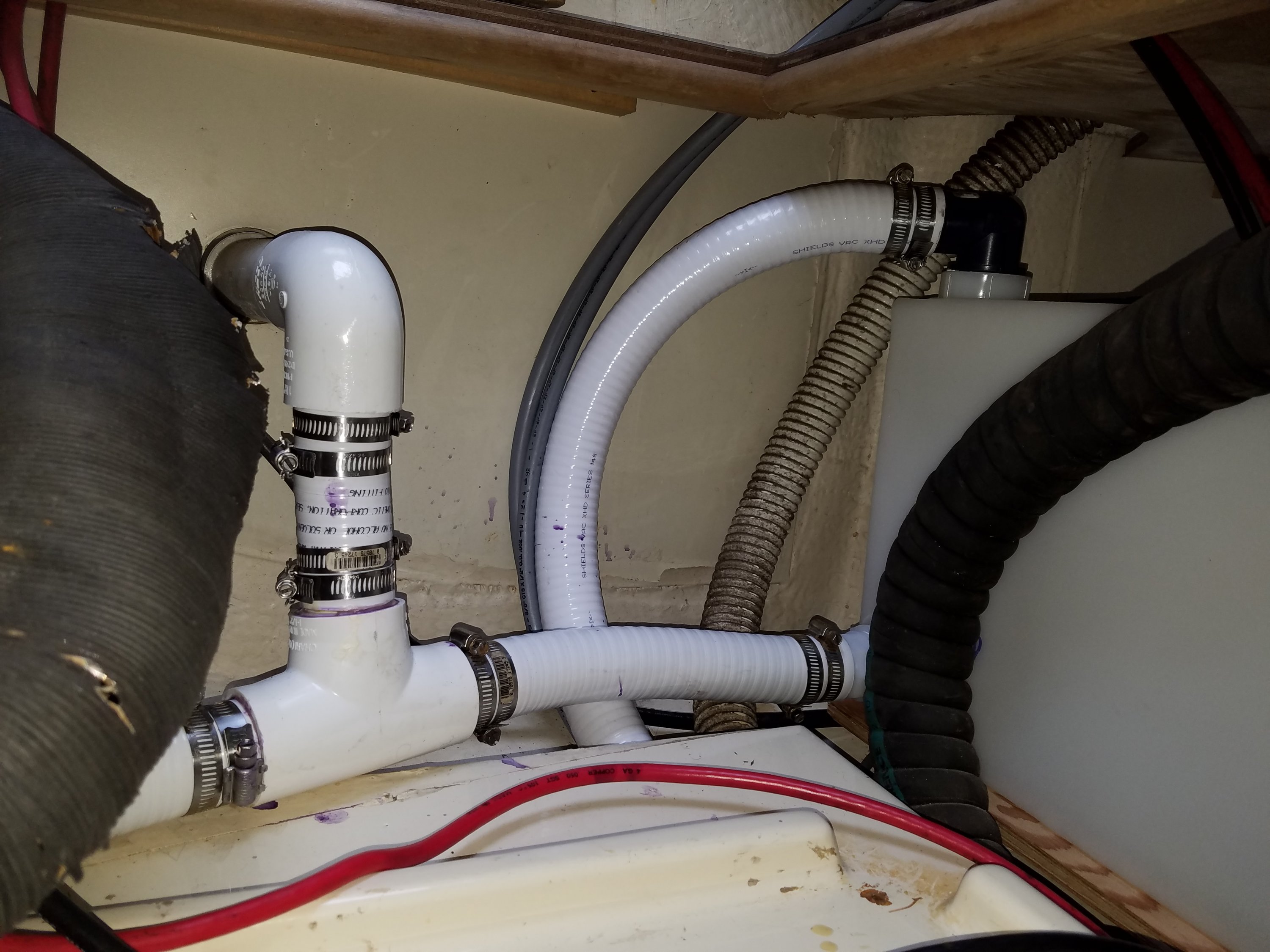

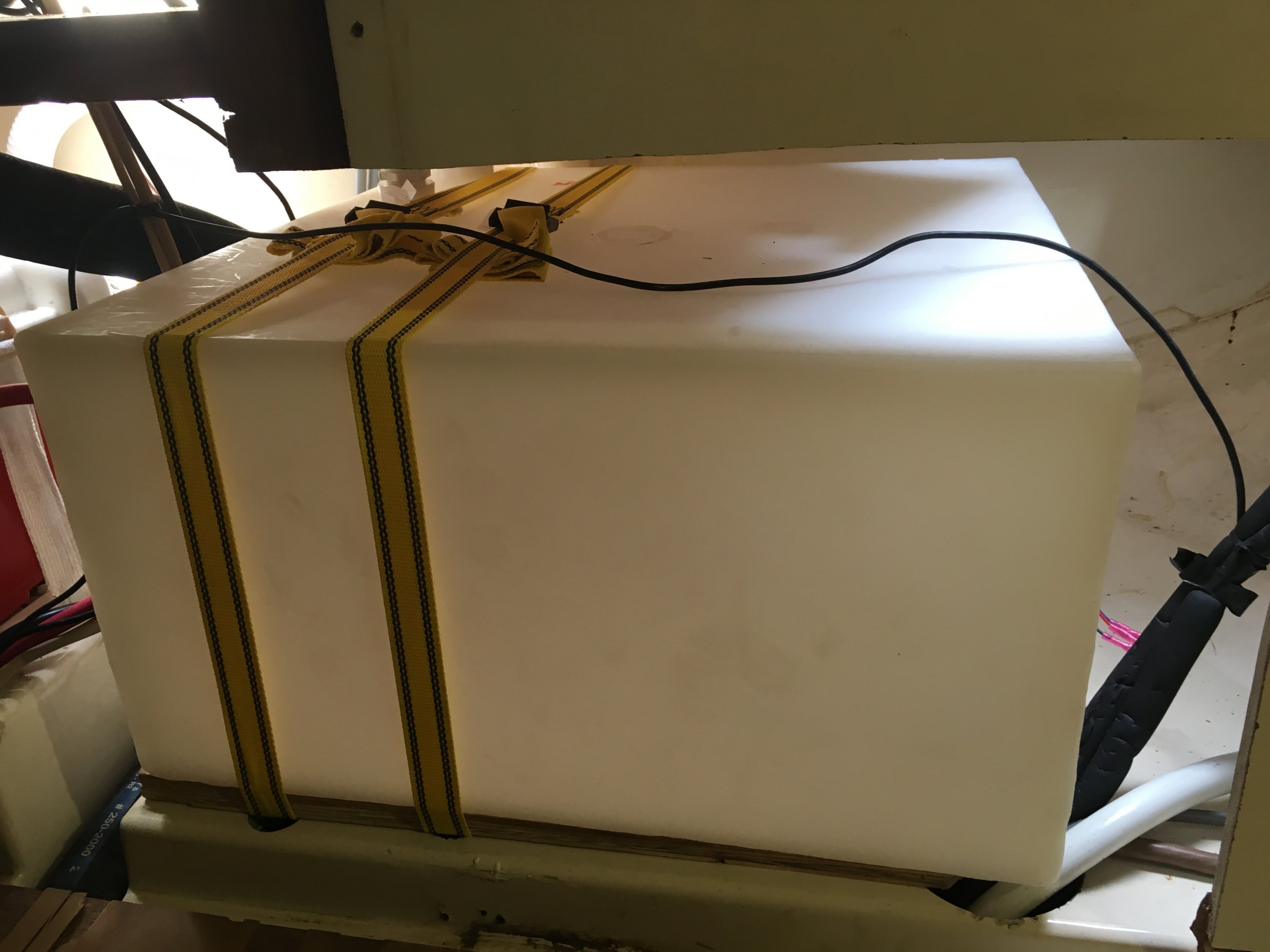

I've been remiss in posting the results of my project. Installation went smoothly with no major surprises. I ordered the B225 tank with a 1" vent opening, but decided to use 3/4" vent hose as 1" just seemed like overkill. If I'm proven wrong, it will be a simple matter of putting in a bigger hose and cutting a bigger thru hull opening.
I had to remove the Espar furnace and still need to get it serviced and relocated. There is plenty of room to install it next to the tank before winter arrives.

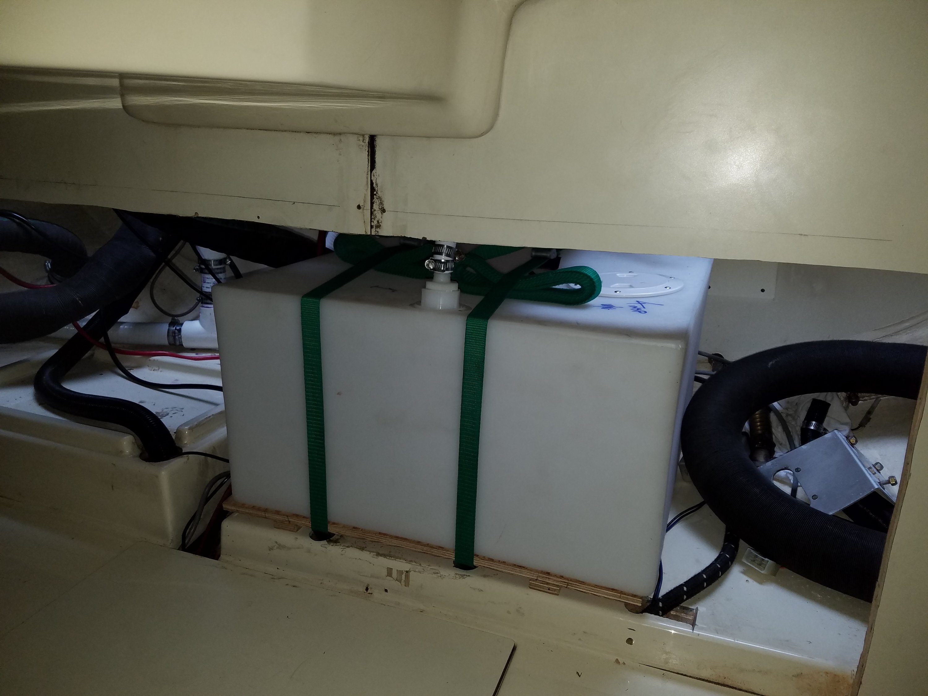

I haven't started mine yet. How far down from the ceiling did you start the cut and how far up from the bed deck is the height of that base you have the new tank sitting on? My bulk head isn't rotted so I was hoping to carefully cut the bulk head and reuse the panel?
Thanks Floyd
tjar
Aug 8, 2011
166
Hunter Legend 35.5 Tacoma, WA
I will have to take some measurements when I go to the boat tomorrow. I had to limit how high I cut up the wall because I didn't want to compromise the floor of the two side lazarettes.
