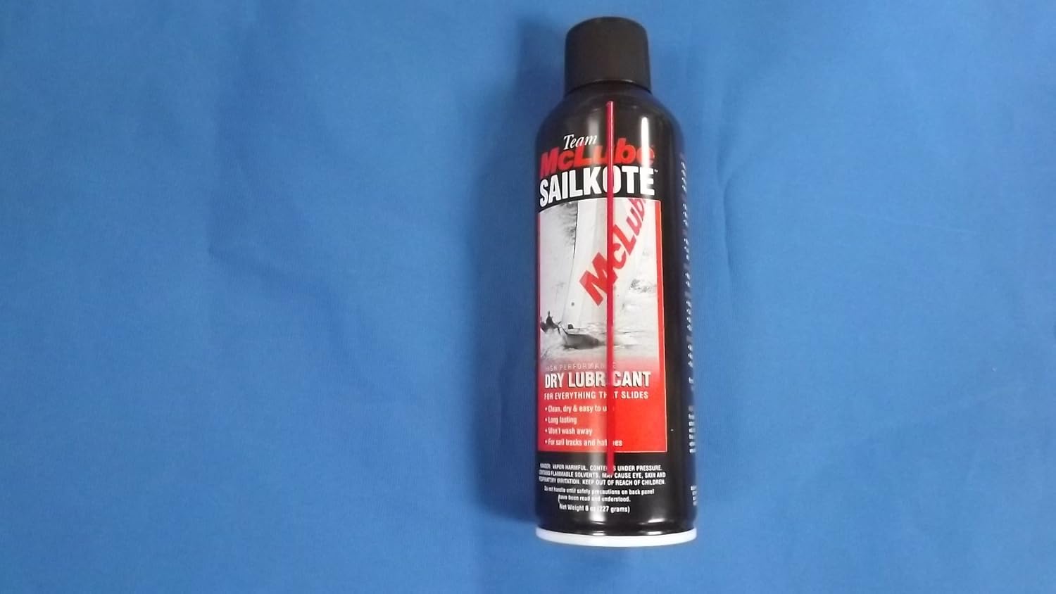

McLube Sailcoat is a great dry lube and should help with your slides.
+1 DO NOT USE WD40 or any other liquid lube.
Use a dry lube like Sailboat or similar.
