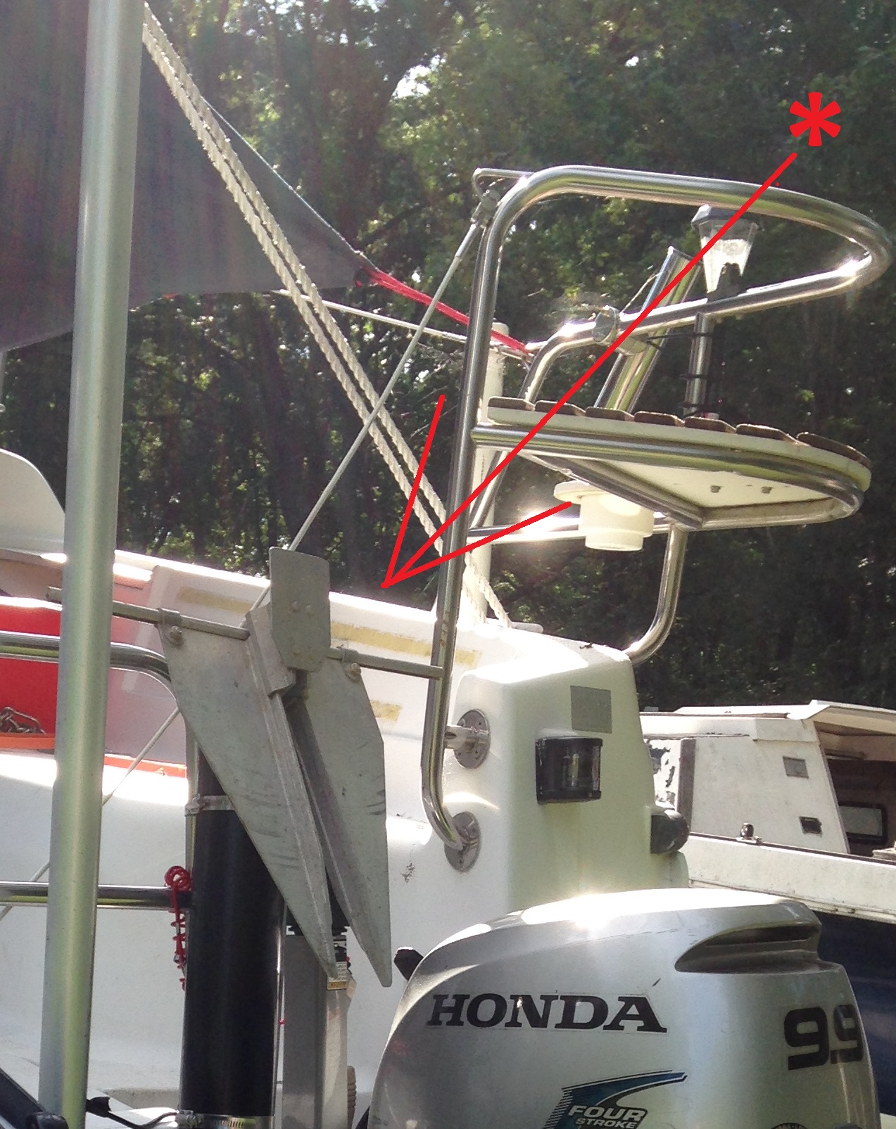

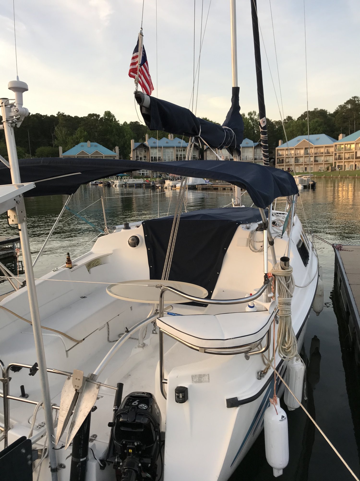

The most useful "cockpit" clutter modification I have made is a PVC tube hose-clamped to my stern rail for an anchor. The line runs forward along the gunwale and I can set and retrieve my anchor from the cockpit. I use it every time I go out. The tube is deep enough to stow 10' of chain and I keep the rode ready to deploy using the rod holder seen in the second photo.

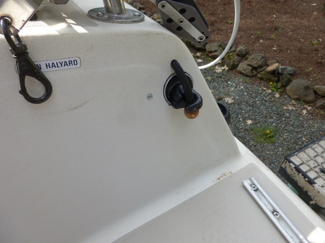

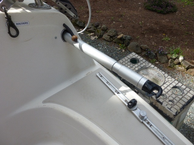

I also like to keep the deck clear, lines neatly gathered etc. one thing that was always in my way was the whisker pole. it doesn't get used every time out, but when I want it I don't want to dig around in the cabin for it so I built this aluminum storage tube into the cabin wall. it tucks up inside the cabin where it's totally out of the way in there, yet quickly accessible from the cockpit. :)

Very clever

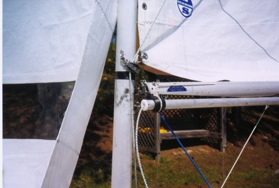

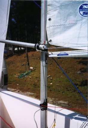

My Windmill has the coolest whisker pole launch system. The pole sits against the boom and runs out to the jib clew through a hinged collar with just the pull of a single line. Shock cord holds it in place.

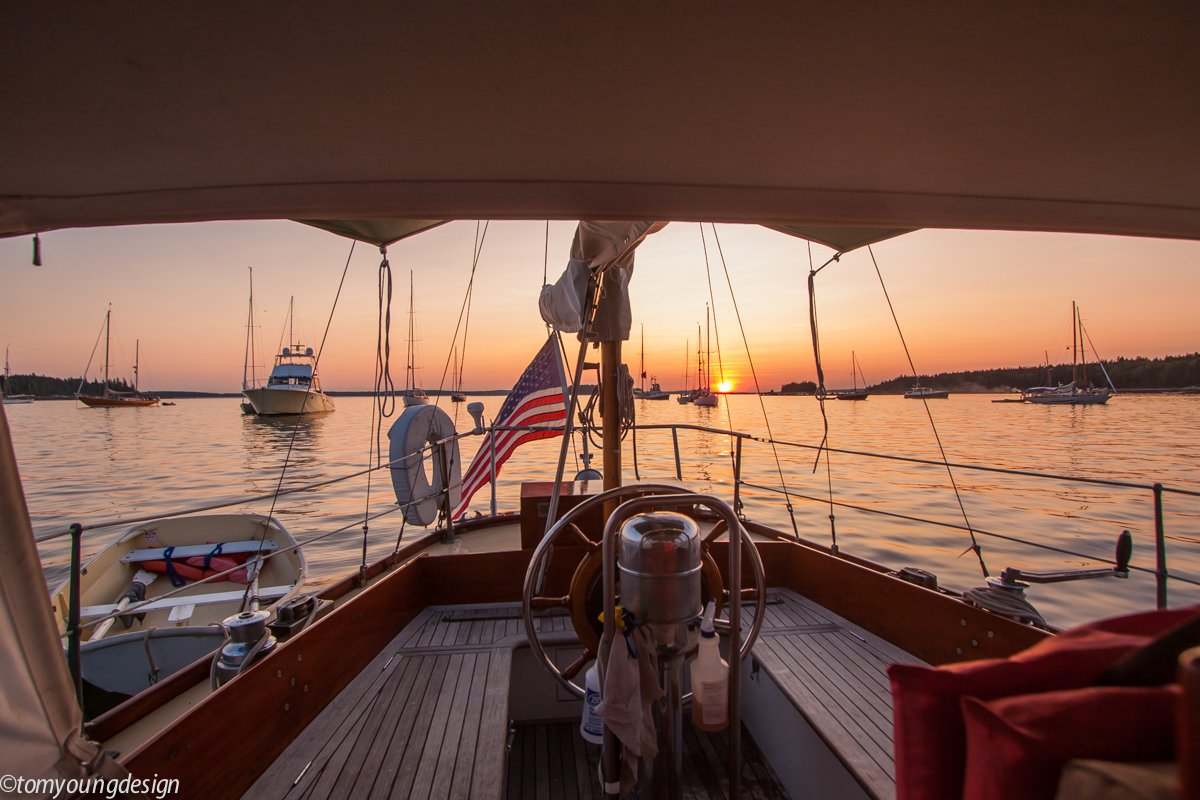

Our old boat is a stor(w)age palace. I think stowage space oboard used to be a higher design priority than it has become.
Two coffin sized lockers that are full hull depth and run under the lazaret to nearly 10' long. Plus a deck box that holds dock lines, propane cans(grill) and misc. allows us free deck space.
But like an attic or garage in your house, great storage space takes management. If you're a boat hoarder, you're doomed. :)
