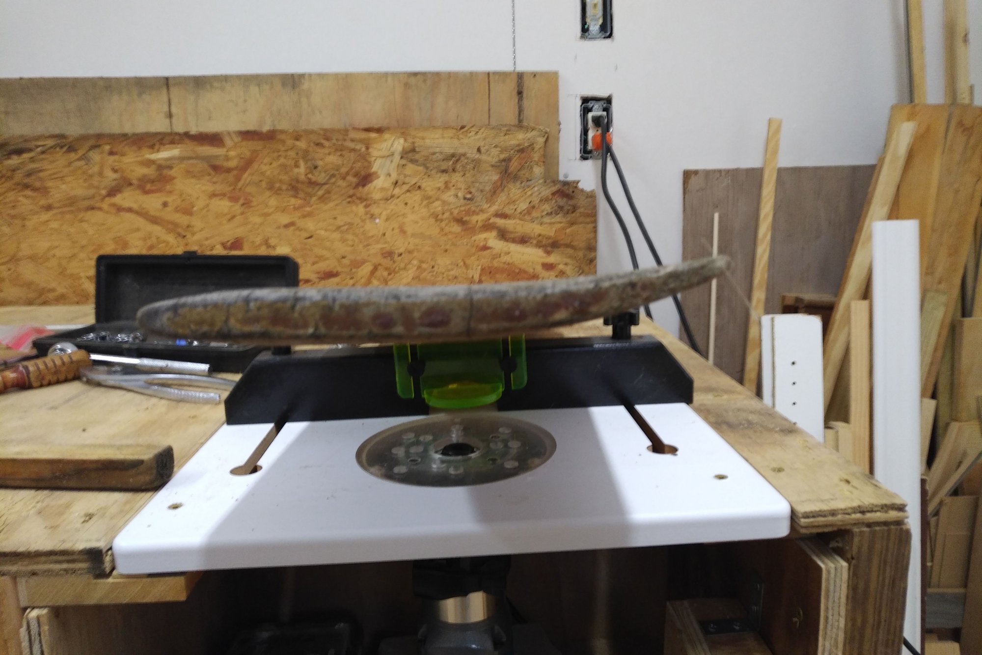

I just picked up a 1982 Vagabond 14. The wood parts need attention. The rudder is warped - here's a shot of the end. Can this be salvaged; if so, how? If a new rudder is warranted, what's the right wood to use?

If it's warped because it was exposed to rain and sun on only one side, you might be able to fix it by adding moisture (hot sponges perhaps) to the concave side. If that works, you would want to clamp it straight with cauls and let it dry, then refinish it.
If you are not concerned with preserving the look, you could flatten the sides with that router table and add fiberglass to build it back up.
If you are making a new one, mahogany would be standard but expensive. Waterproof plywood would work, but not look as nice.
Thanks! Not too concerned with appearance. It was exposed to sun and rain by previous owner. I will protect the wood parts and sails from this point forward.

My carpenter friend said he sees no way to correct the warpage on the rudder. So I will plan on building one. Will keep y'all up on how it goes. I appreciate your help!
