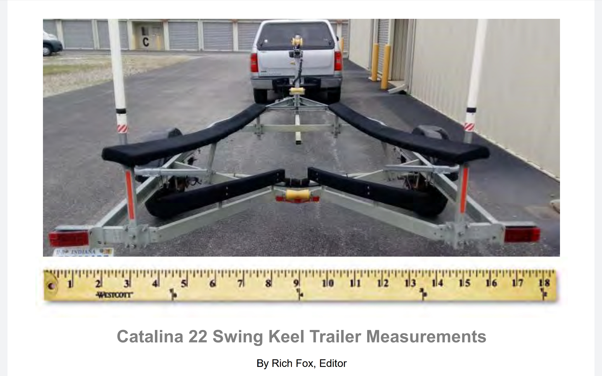

Newbie here. My failure to control an impulse has left me with a c22 swing keel in decent condition, but sitting in the water without a trailer. Can anyone provide me with the minimum trailer length, width and bunk height and layout for that boat?
Much appriciated.

Do yourself a HUGE favor.
Join the Catalina 22 Association.
There is a wealth of information there, it's all Catalina 22 specific and their tech manual is well worth the cost.
I think it was $50 for the membership and that gives you access to the tech manual.
You get tech articles on nearly every possible modification or repair that can be done to a Catalina 22.
These articles go back to 2006?
Here's the article directory.
Anyway the trailer measurements are in these articles.
I'll try to diagram them up and post it for you.
