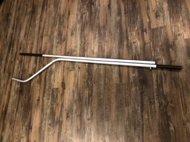

My 170 came without a tiller. I was unwilling to pay big bucks for a piece of wood despite the fact that it is pretty. It is at its core, a hinged stick.
My solution used EMT conduit. It cost about $10. The hardware cost about $1. The bender was borrowed but they can be found for about $20. I will wrap it for aesthetics eventually. If anyone wants more detail, just ask.
