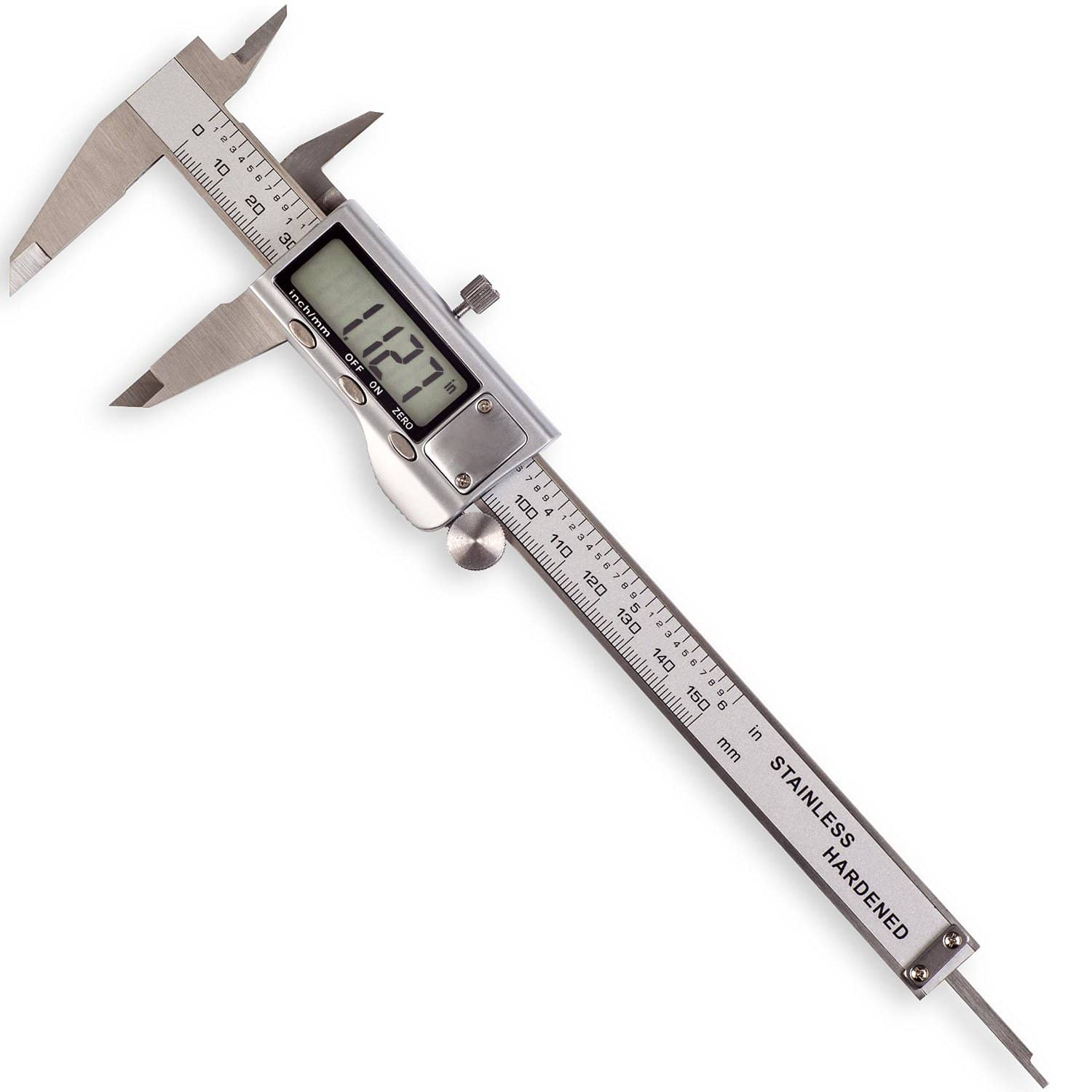

Hull #37 here, built in 98. Our shaft was 1 1/8. We just put a 15" 3 blade Maxprop on her last year. Could have went with a 16", looking back. There are at least 2 if not 3 different transmissions for these 3JH2E engines so shaft size could vary a bit. I'd definately pickup a caliper to make sure. The new prop went on very snug initially. Hope that helps.I bought a Tartan 3800 (named Sanguine) 1998, deep keel. I need to replace the prop but need to know the shaft size (it has the Yanmar 38HP diesel). Does anyone happen to know?
