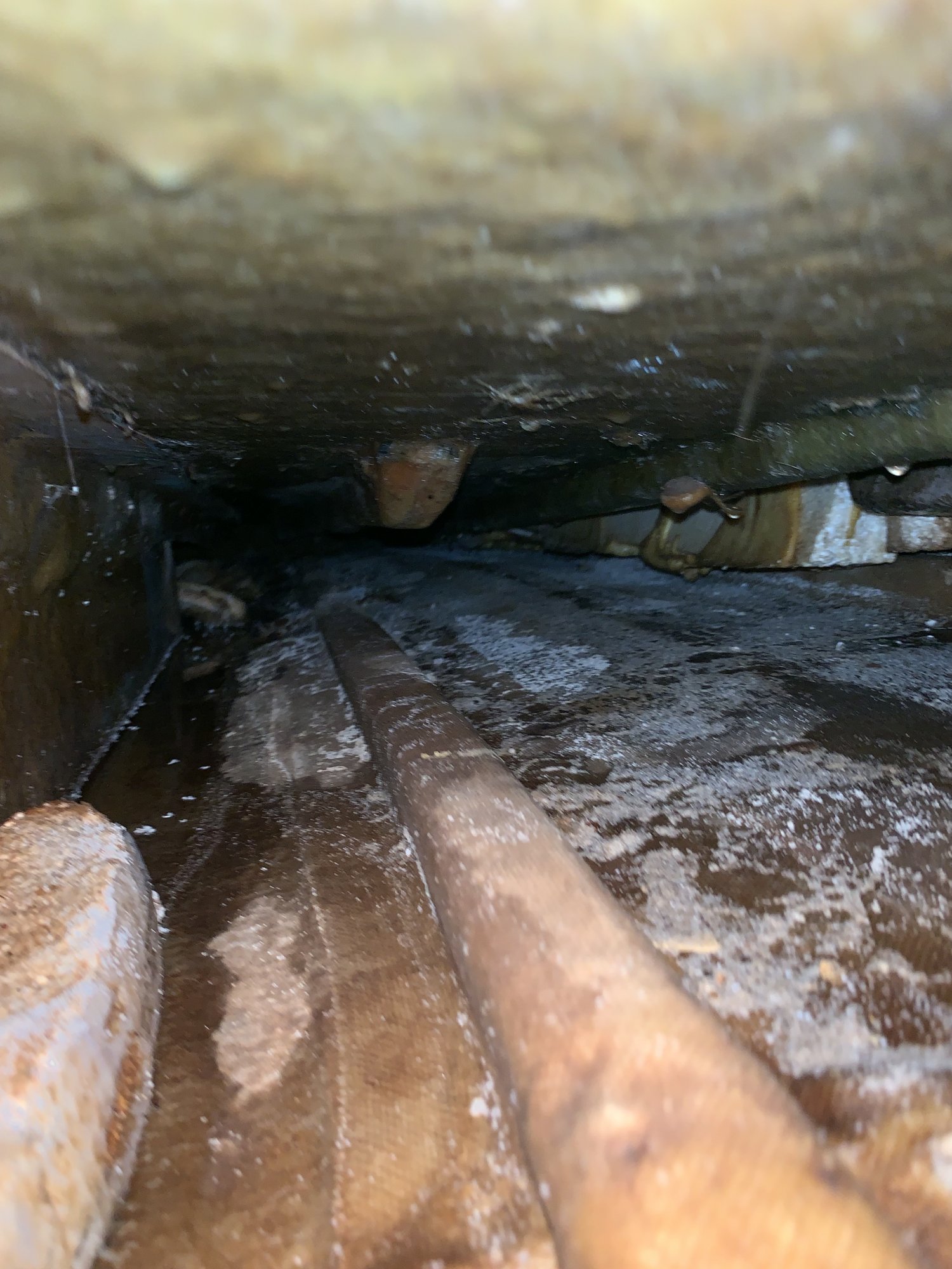

I recently purchased my first sailboat, an old O'day Day Sailer II that needs some work. My biggest concern at the moment is the inner hull containing moisture. The boat had been trailered for almost 20 years by the previous owner, and I have yet to sail it. On inspection of the inside of the hull over a period of a few months I noticed that there were several moisture stains and sometimes what seemed to be water inside of the hull. There is a large amount of salt-like material as well. After some research I concluded that this is most likely some sort of hygroscopic bi-product of the fiberglass resin, but I'm not sure. There are no signs of blisters, but I need to remove the moisture and the salty-material. I attached a photo of all of this.
Any suggestions on how to best do that? How should I proceed to avoid further damage?

Did you test the crystals to see if they are salt? Dissolve in water a taste a drop.
That picture looks just like what the inside of a hull looks like when a lot of salt water has evaporated over time.

Way in the back is what looks to be Styrofoam. This was often used for positive bouyancy and structural support. Stryofoam also absorbs water and does not give it easily. Sunfishes are notorious for this. So, some of the moisture you are seeing may be moisture coming from the styrofoam. If it is saltwater the residual salt will suck water out of the air.
While the boat may have always been trailered, that doesn't mean the boat hasn't been flooded on one or more occasions. Have you always remembered to put the drain plug in before launching? Be honest. ;)
And to prevent comments from our resident chemists, the styrofoam itself doesn't absorb water, the water enters the the little spaces between the balls of styrofoam, kind of like a sponge.

I bought one of these boats a few months ago. I trailerd it almost 400 miles home. When I opened the bilge drain water started pouring out. I think it drained for 20 minutes. There was probably 500 pounds of water in the 600 pound boat. It may have been there for over 10 years. The PO (my older brother) new nothing about it. It had been stored in a barn for 10 years.
There doesn't seem to be any harm done. The boat sails great and isn't taking on water from the hull. I think rainwater gets in through the mast step.
I think I would probably not worry about a little moisture. Just leave the bilge plug out and store the boat in as dry a place as possible.o

I used to own one of these... they are an excellent first sailboat... you’ll love it.
There are a number of ways moisture can get into the bilge in a DS2... the gap where the centerboard control lines go thru from the outer to inner hull is the likely suspect... and it is possible to fix the issue... though whether its worth it depends on the amount of water involved. I got in the habit of opening the hull plug... draining the bilge... after each sail and was able to live with the problem.
