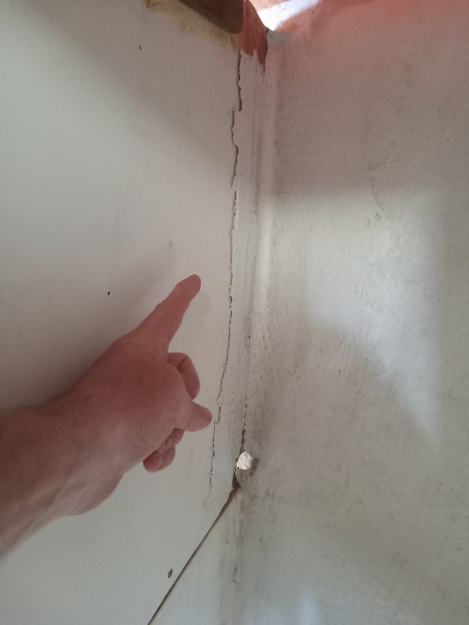

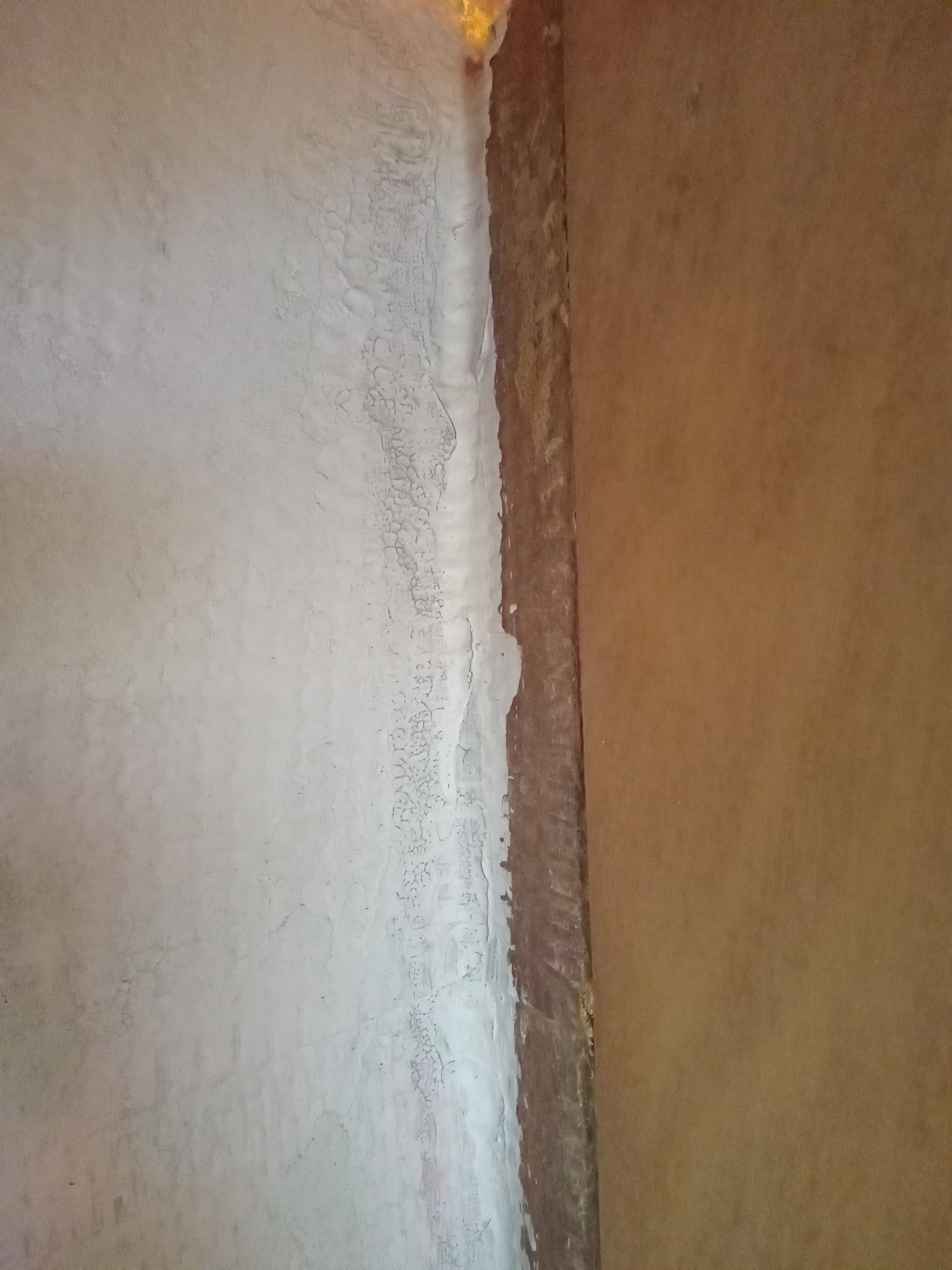

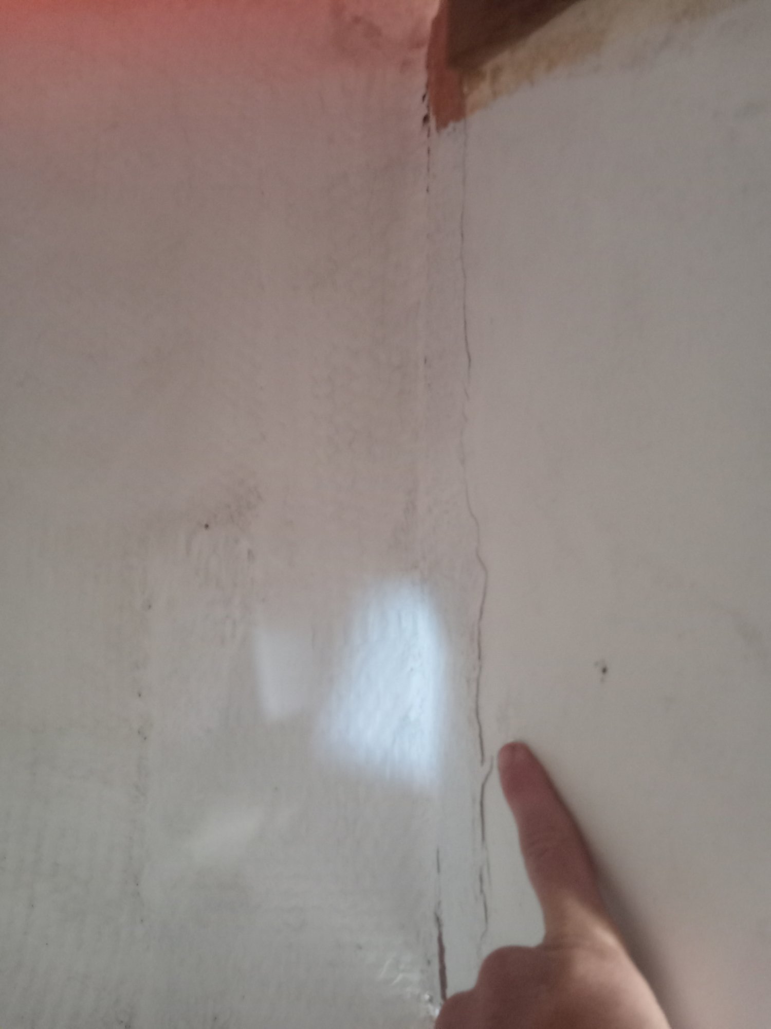

Is this bulkhead structural? I will be sealing off the engine compartment left and would prefer to remove this piece if I can. The space will not be used as a berth but as storage so I would rather have it open to access that area. Grey tube is manual bilge pump hose.

How it's attached should tell you - if it looks like a panel that could easily be removed, no. If it's securely fastened to the hull and deck, yes.

It's not tabbed in. I could pull it out by removing two screws. It's just hiding some pipes and wire in my opinion.

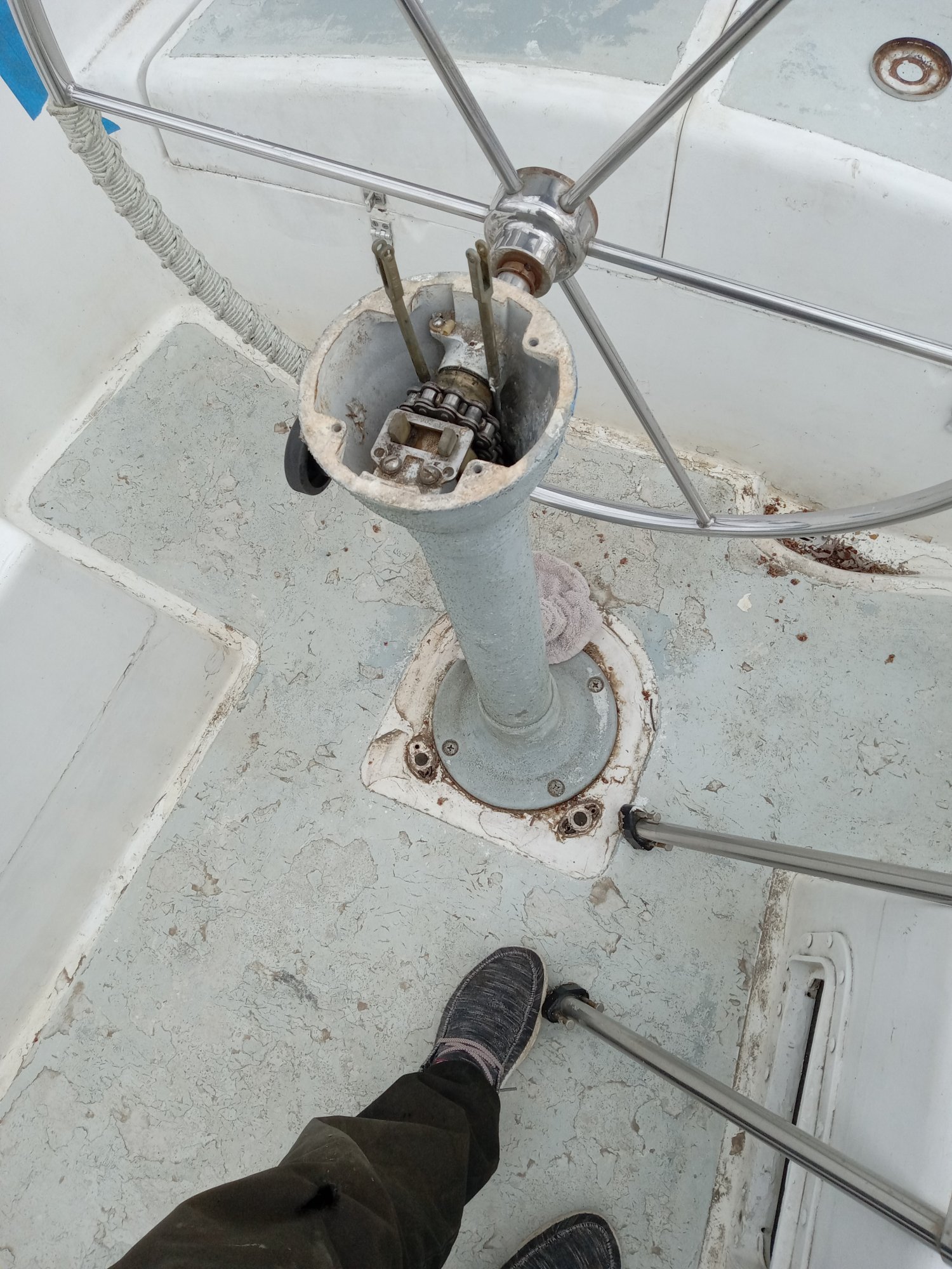

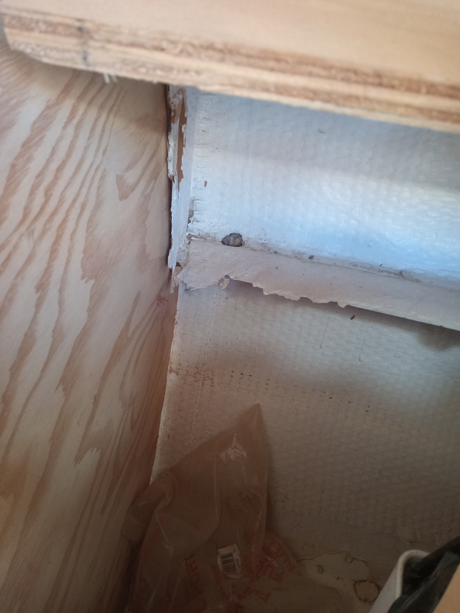

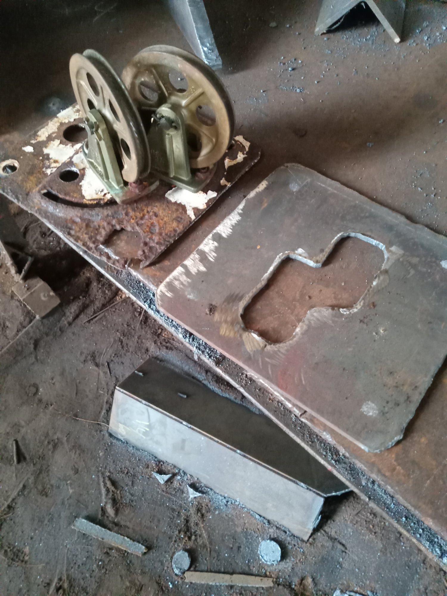

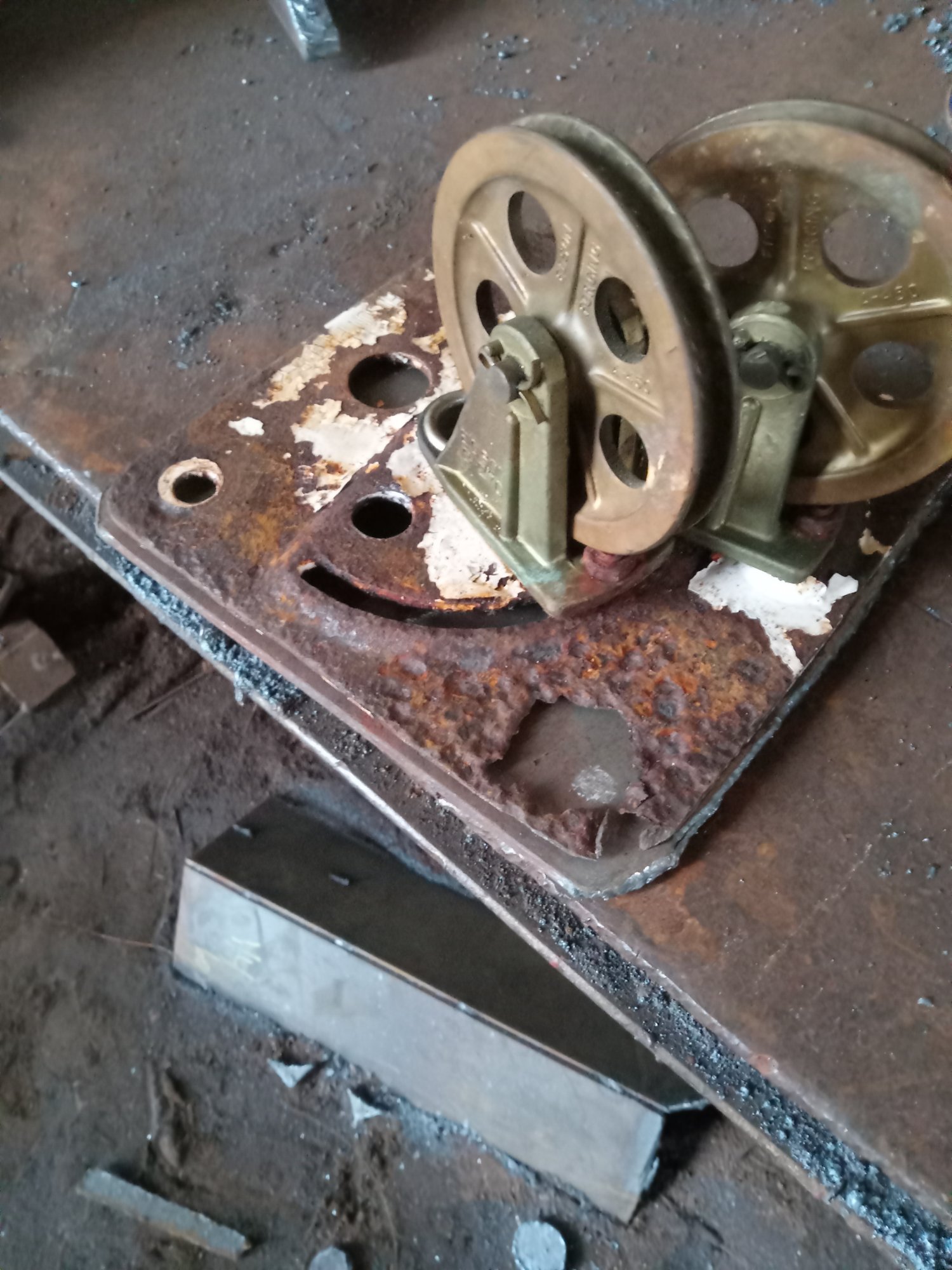

Thank you for the more detailed post on the process! I can tell from where I removed the helm that the core is in really bad shape. My backing plate had corroded so bad that one corner fell off when I removed it. I will replace the core completely with coosa board and rebed the helm after. Adding some photos for context. Before helm pic. Will post current picture soon.

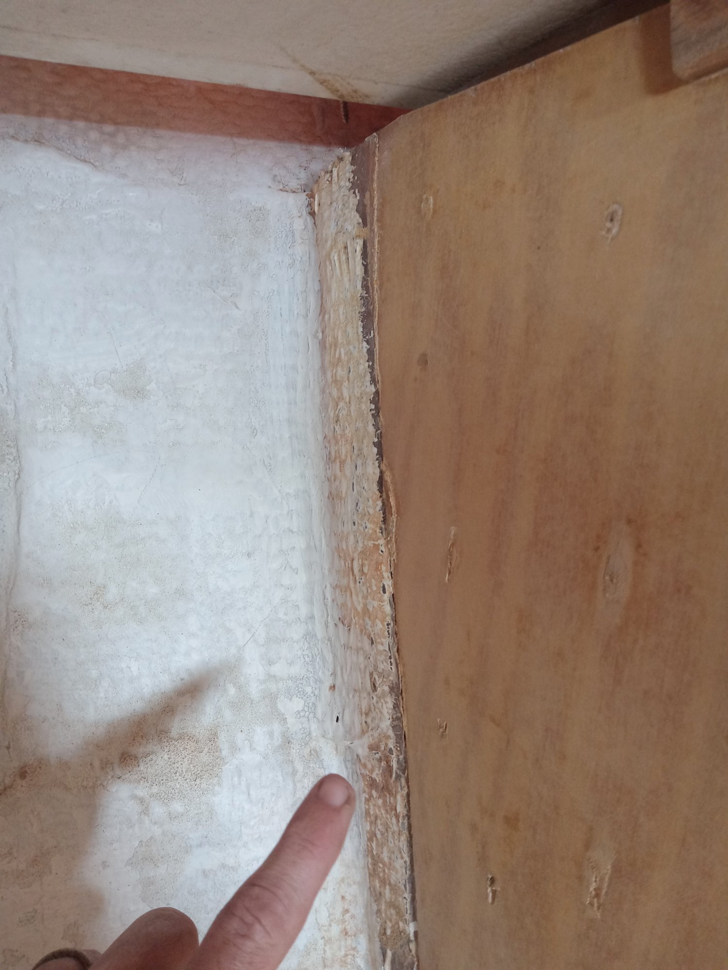

There are only 2 pieces of ply in my boat that were not fiberglassed to the hull, the one I mention here and the removable board separating the v-berth from the anchor locker.

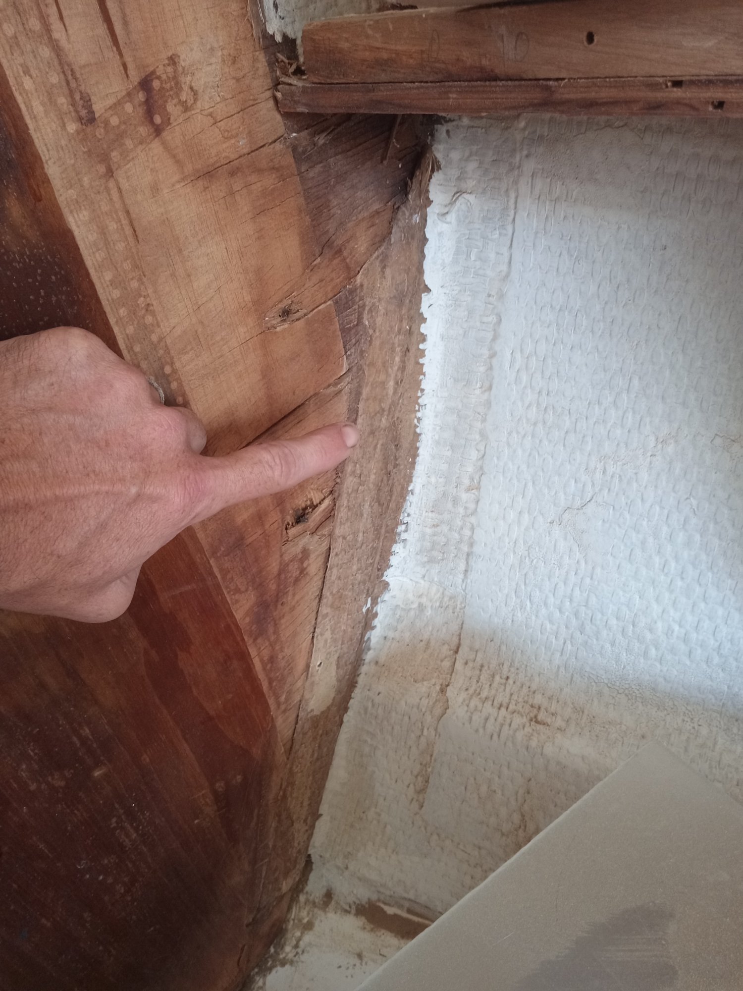

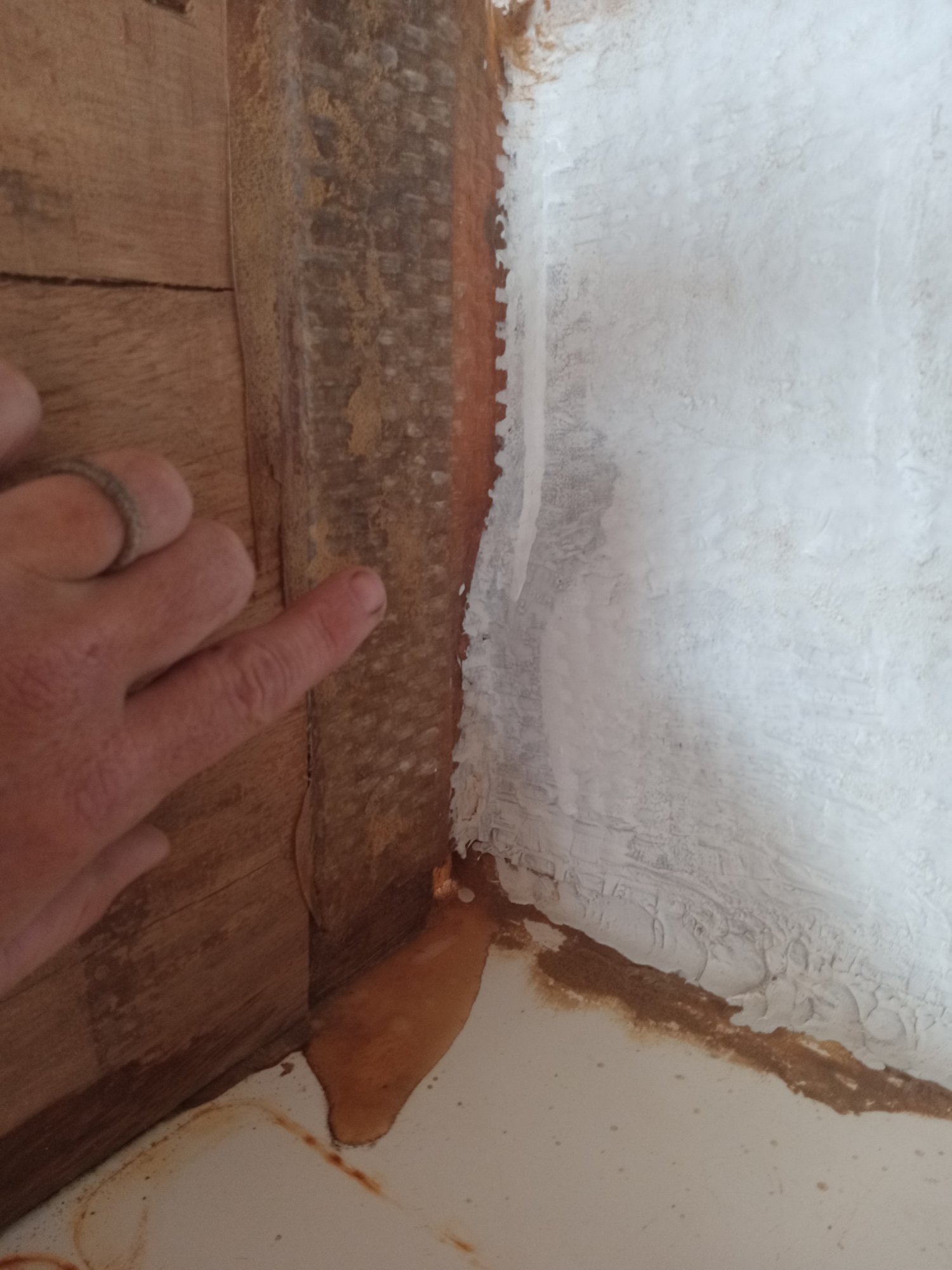

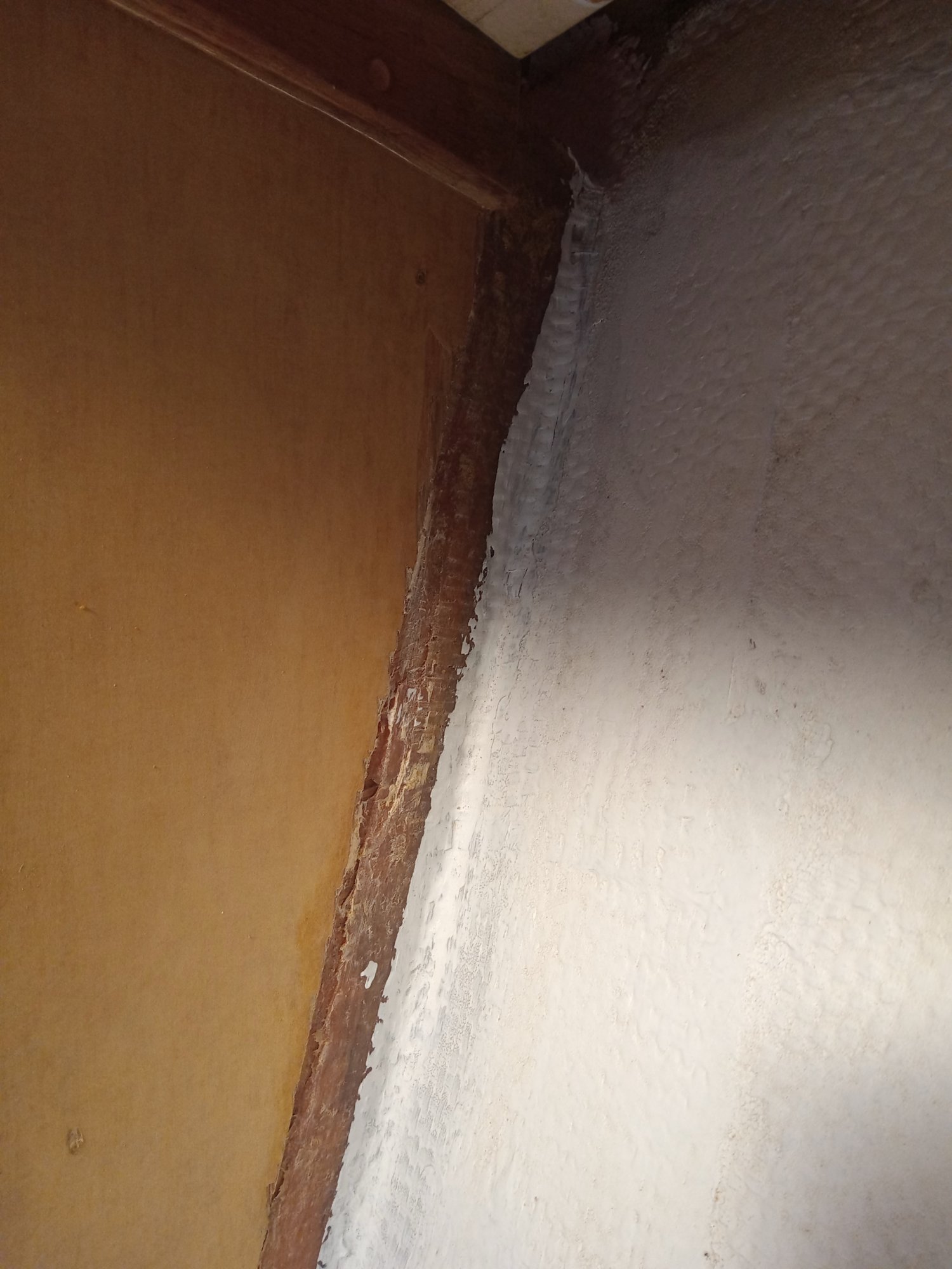

Caught me off guard early this morning, sorry for the snark. Here are all the places where the manufacturer tabbed ply to the hull.

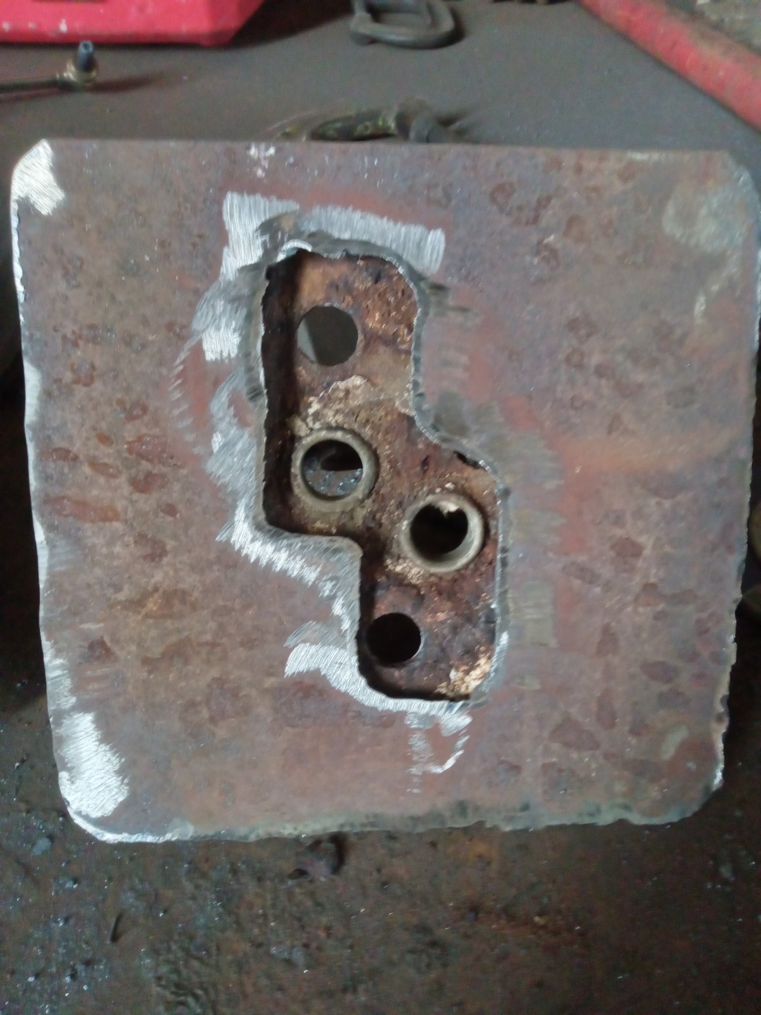

When you finally do sail your boat, you will be reminded of sailing in a wooden sailboat because the plywood partitions that are just slotted-in will creak as the hull works in a seaway. I'm glad you are addressing the mild steel plate that carries the steering sheaves. I had mine sandblasted and epoxy painted. The manufacturer (Edson) should have used SS plate.
Looking at yours, I'm not surprised the cockpit sole is spongy. Don't forget to take care of the opening ports when you are repairing damaged plywood core; once removed, you will probably find water damage in the cabin sides too. Replacement OEM Gray ports are available from the SBO chandlery. Others have used Beckson and NFM (New Found Metals) ports. The Bomar hatches are pretty good quality and may only require re-bedding and new gaskets. The area around the the companionway also needs a look, and the dorade boxes are a know problem. But, overall, you will find you have a very solid boat, worth your time and effort.
