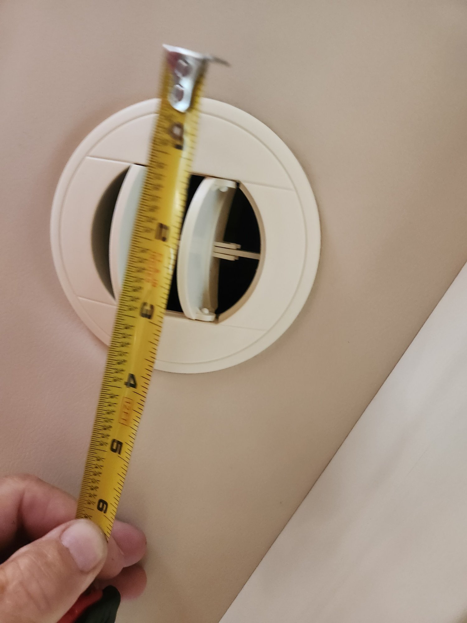

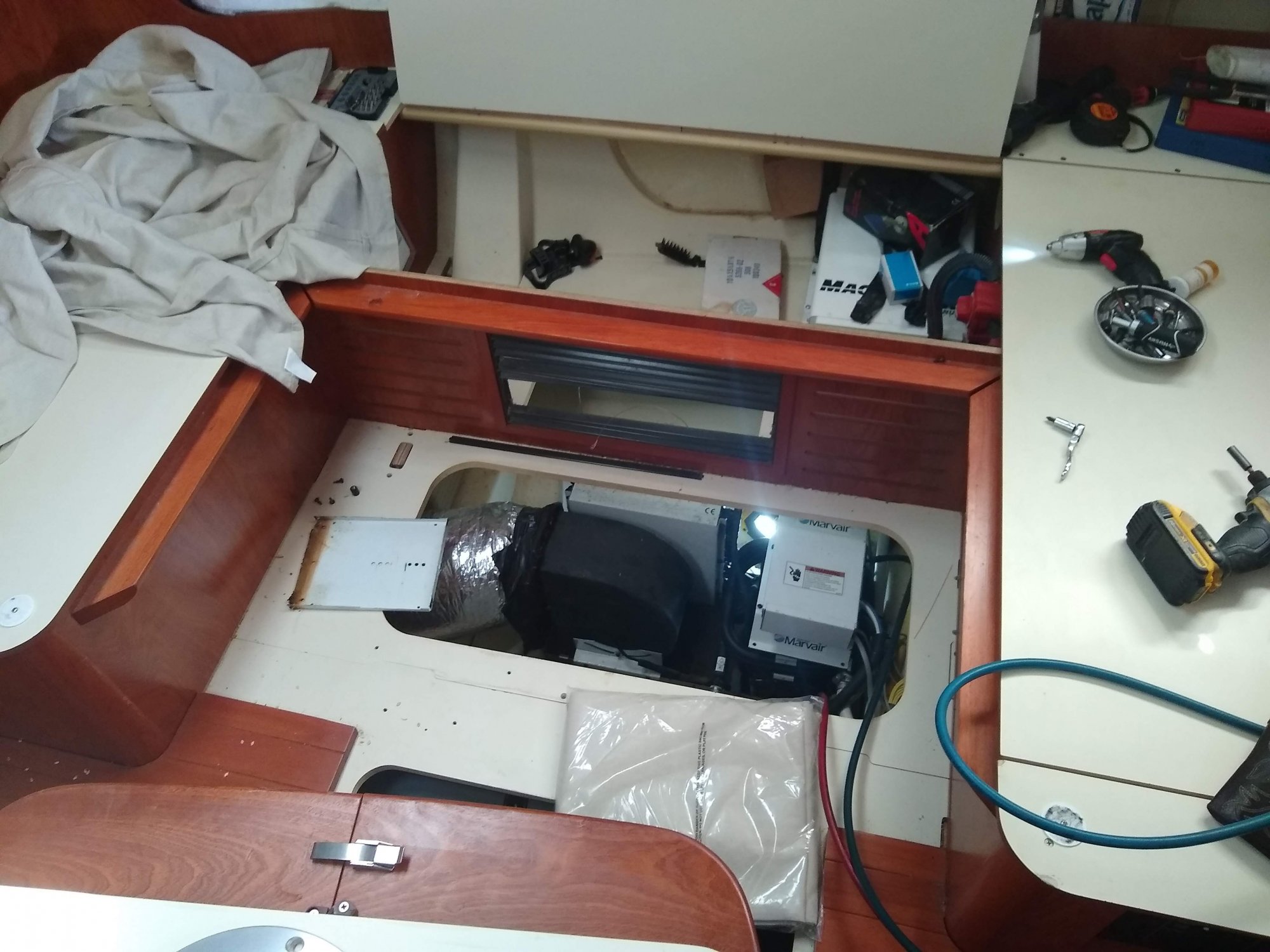

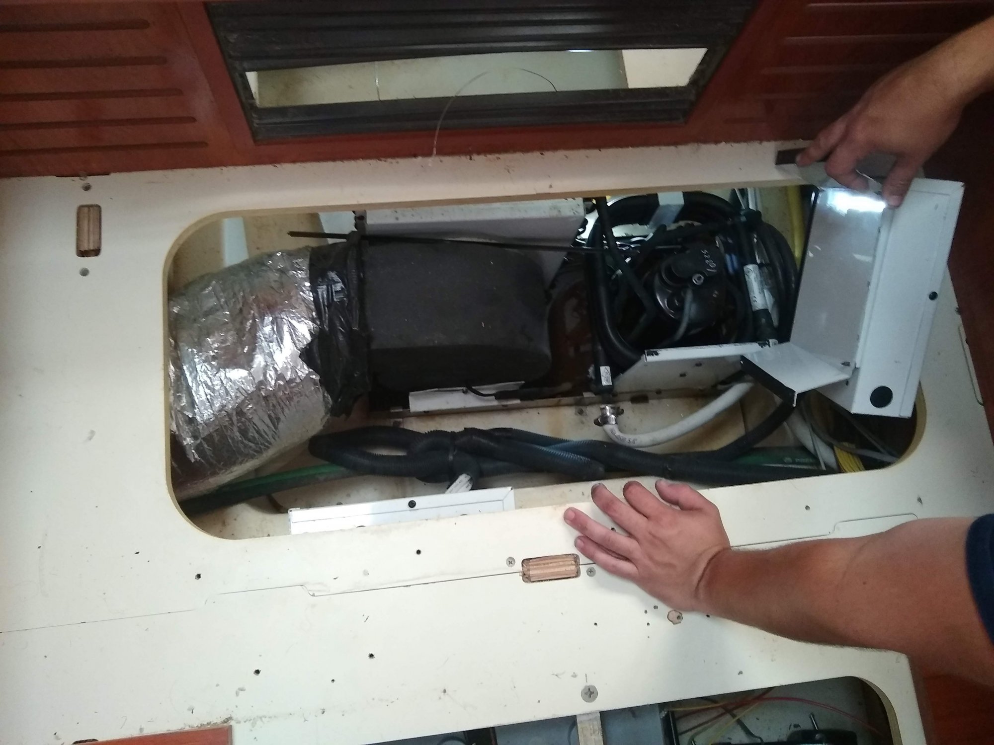

I have a H49 that was originally from SoCal so the temps were reasonable, so the original owners did not opt for AC, the boat is now in Houston which has a little more heat in the summer. I am in the process of seeing what it would take to install AC in the boat. The wiring, plumbing (not including through hulls) and air conduit are already in place on the boat, thanks to Hunter. One of the issues I have run into, how are the AC vents attached to the conduit? Is the conduit strong enough to be able to use screws? What size are the vents (assuming 2-inch)? I assume the vents were optimized for the size of the conduit, would anyone change the vent sizes or shape?
